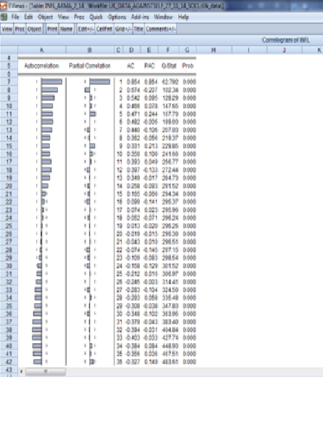

I have been asked by my boss to learn how to use eviews and he has given me some practice questions and before I go and see him I was wondering if anyone could assist me so I go into the meeting with the correct answers.
For one of the questions I have been asked to:
Compute, plot and interpret the Auto-Correlation Function (ACF) and the Partial AutoCorrelation Function (PACF) of inflation. What AR, MA or ARMA process seems most appropriate?
For this I did a correllogram as shown in the attachment. From this I decided that the model was an ARMA(2,14) however I feel like this is incorrect and it could be a MA(2). If anyone can assist me it'd be very much appreciated.
Oscar

It can't be an MA(2). In an MA(2) the autocorrelations go to zero after two lags.

Sorry I meant AR(2)? I've been staring at this for a few weeks straight that I'm finally getting all my answers crossed...
This is because the PAC is more than -1/1? This makes me think its AR(2)?
The reason for it being ARMA(2,14) is that the PAC at 2 lags is more than -1 and the AC is more than 1 until 14 lags?
This is a new topic to me sorry I know some of this is probably pretty basic..
What would you make it?
