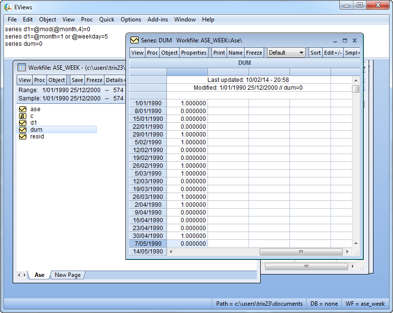

you mean the dated-regular frequancy (weekly)
1-create dummy equal 1 for the first and last week in the month for every years.
2-create dummy eqaul 1 for the first third month...etc for every years.
see the picture below, I have ateched my workfile.
