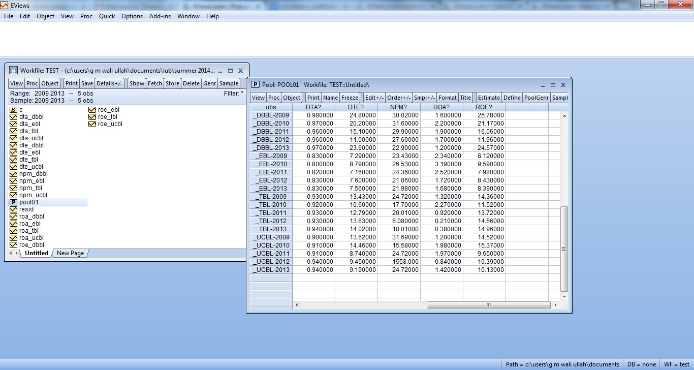

I have five variables, with four cross sections identifying four different banks. I want to run a correlation matrix for the pooled panal data but can't figure out how it can be done. I have uploaded the stacked view of my data, where there are data of 5 years of four different banks, for each of the five variables. Please help me out ASAP!

Can you be a little clearer about what you want to compute? Do you want correlations for each of the individual variables across cross-sections? Or correlations between variables ignoring the bank identifiers?
