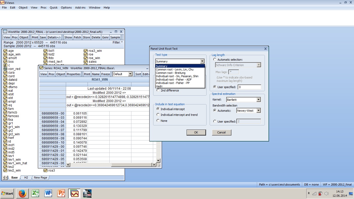

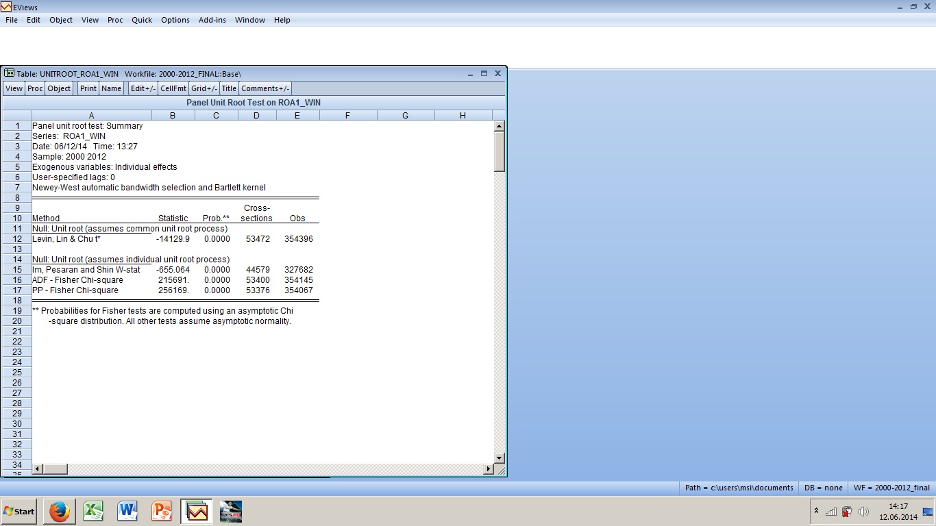

so I wanted to do and ADF/unit-root test on a series (which is part of a panel) in EViews 7.2, but the choices are not as in EViews 7.0, and neither are the outputs.
The second picture shows the options that I get to choose from - which one is the ADF test?
The first picture shows the output - looks nothing like in the manual - where do I find my ADF critical values and the test-statistic that the test gave me?

The ADF test is not appropriate in a panel setting. Some of the panel tests are similar. Notably the one that is labelled "ADF" :D.

Thank you! So I'll just use the "Individual root - Fisher -ADF"?

Some of the other tests, e.g., Levin-Lin, are panel versions of ADF tests. You should take a look at the documentation and the literature on panel unit root tests.
