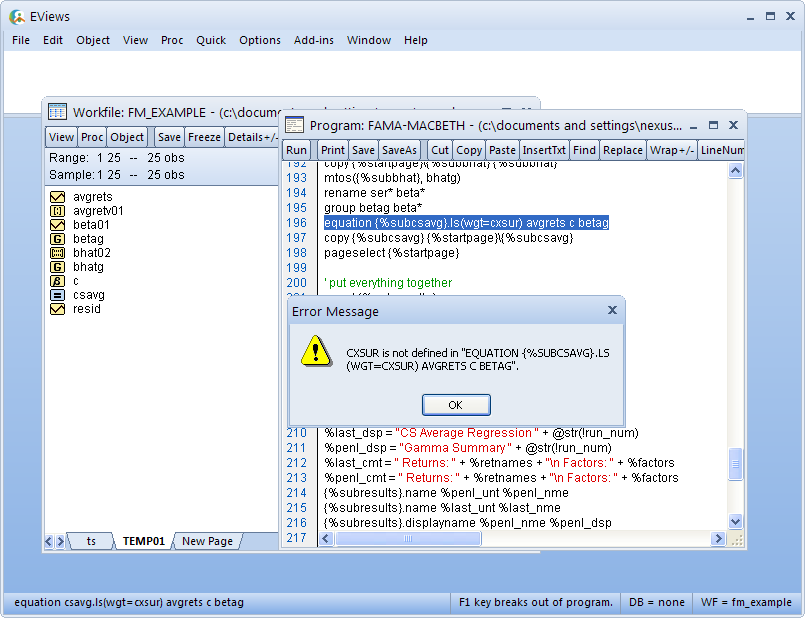

I thought that this line
equation {%subcsavg}.ls(cov=hac) avgrets c betag
I have change it by this code (Ref: EViews 8 command ref pp 382 Panel LS Options)
equation {%subcsavg}.ls(wgt=cxsur) avgrets c betag
but an error message appear.
I don't know what to say :| thanks for the help.

You don't have a panel.

Looks like the subroutine FMB is the part that does the calculations. The line:
rowplace(g, @transpose(@inverse(@transpose(design) * design) * @transpose(design) * retvec), j)
is the one that performs OLS and puts the row of coefficients into the matrix g. Just change that line to do whatever calculation you want, instead of OLS.
