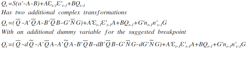

Is it possible to adapt the add-in to allow testing for structural breaks (making use of any of the proposed structural break methodologies )
Can someone tell me how to verify a structural break at a known date using this model and program
Aaron
trubador
Did you use forum search?
Posts: 1520
Re: DCCGARCH11
Postby trubador » Tue Feb 17, 2015 1:25 pm
No, the add-in does not have any formal structural break test. You can, however, generate dummy variables and use them as exogenous variables for the mean and/or variance equation. And then you can interpret the significance of coefficient(s) to serve the purpose.
wildee
Joined: Tue Feb 03, 2015 10:37 am
Re: DCCGARCH11
Postby wildee » Wed Feb 18, 2015 4:55 am
Thank you, that should be sufficient to verify a claim for higher correlation in the latter (post known break point) part of my series?
There is an endogenous dummy variable method that I am investigating and is shown in the line below, this is a different structural break method to those I have seen so far and would it be possible to perform this within the add-in? The attached file shows the transformation under this method.
Aaron
