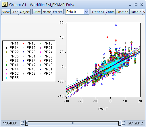

2/ this code in page 8 show all pr* with rmkt in one graph, how can make all this in the separate graphs with spool object?.
group g1 rmkt pr*
g1.scat linefit- Attachments
- fit.png (27.89 KiB) Viewed 33535 times

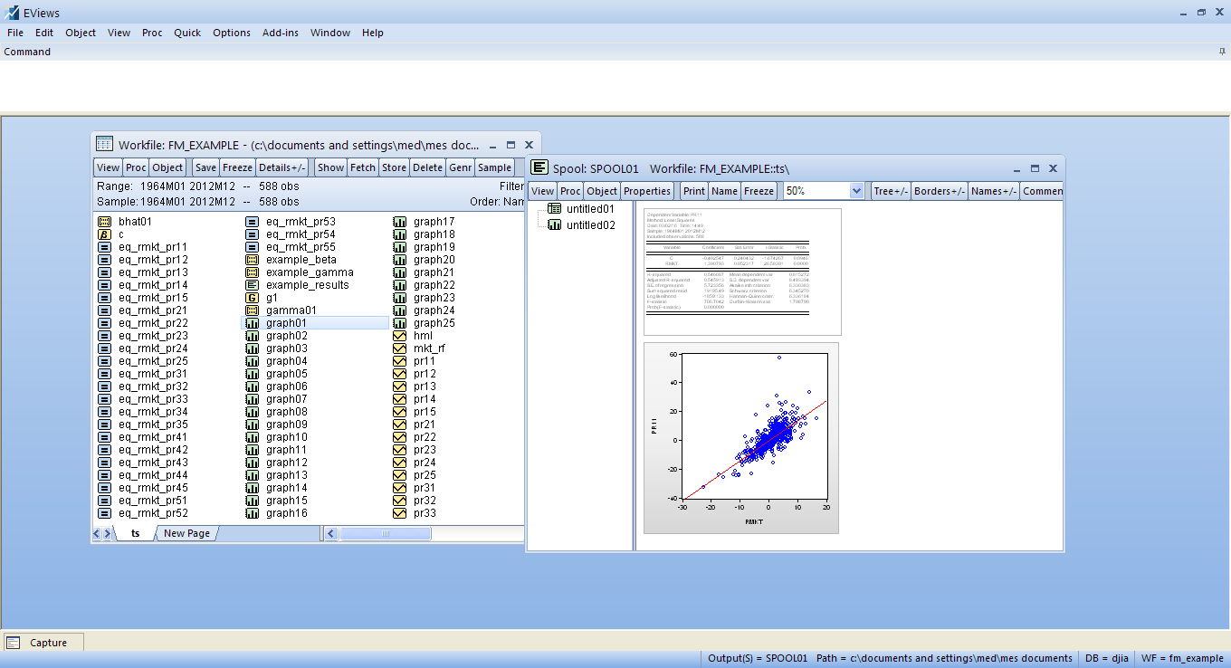

1- got it, but how can get series avgrets;
2- run all graphs pr* on rmkt with regression line one at a time by simple code (pr11 with rmkt, pr12 with rmkt,....etc), and all this in the spool object (each graph appear separately in the spool).

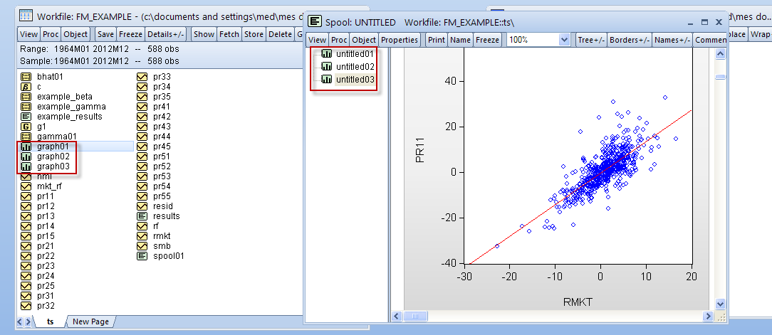

2- i explain, i write a short code that generate regression one at a time, but with all graph pr* rmkt no idea:
i would like to make all regression equation and graph pr* on rmkt one at a time with a linefit, and put regression equation and his graph in the spool (each equation and his graph linefit), can you help me for this code
i hope that you understand me now.
Best Regards.

- eq_graph.png (64.61 KiB) Viewed 33469 times
