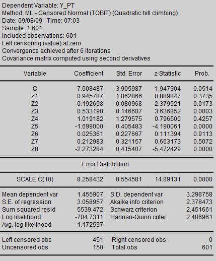

I use the example file "tobit_fair.wf1" in the following path:
"C:\Program Files\EViews6\Example Files\EV6 Manual Data\Chapter 30 - Discrete and Limited Dependent Variable Models"
when estimate eq_tobit again,it can not report R-squared.
It has no problem in eviews5.
How can I solve the problem? Thanks!

Previous versions of EViews reported *an* R-2 measure which was based one of the residuals formed by taking the observed data minus the expected response. This is a perfectly valid R-2, but it has some undesirable properties and other better ones have been proposed in the literature (the McFadden R-2 is one example). As a result, after some discussion, we decided to not compute an R-2 for tobit models in anticipation of a more general set of goodness-of-fit measures. There are a number of these measures, and to be honest, we don't believe there is yet a consensus on which ones one should look at.
Most of these, however, can easily be computed using EViews. If you would like to propose a candidate measure, we can discuss how to compute it...
