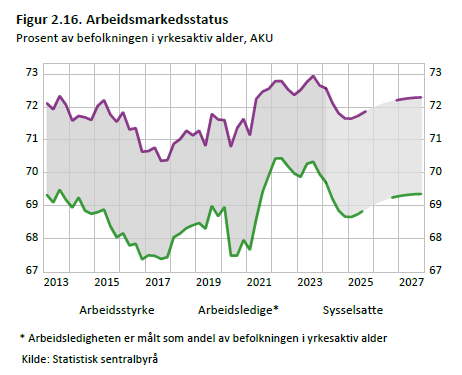

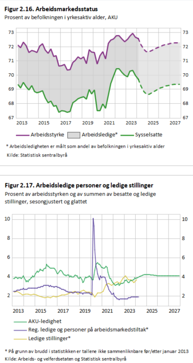

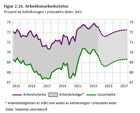

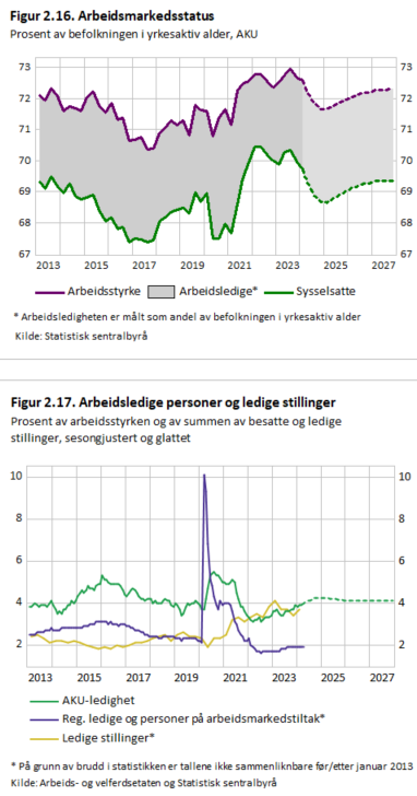

I have enclosed two screen shots of two spools generated by the same EViews program written by me. The only difference is that the program generating the spools was run on two different versions of EViews: EViews 12 and EViews13. Each spool was saved on disk by the manual EViews menu operations Object->Print->Printer: Microsoft Print to PDF. The resulting pdf-files are also enclosed. The pdf-files show all graphs in the spools, not only the graphs in the screen shots of the spools displayed in EViews.
The graphs are ok in the spool and pdf file generated by EView 12, but not in the spool and pdf-files generated by EViews 13. In the latter, the dashing is different (and missing in Fig 2.17) in the spool, and looks terrible in the pdf. In the pdf the lines are missing in the legend.

- Spool EViews 12.png (124.45 KiB) Viewed 72944 times
- Print pdf EViews 12.png (31.89 KiB) Viewed 72944 times
- Print pdf EViews 13.png (35.15 KiB) Viewed 72944 times

One spool did not make it into the previous reply
- Spool EViews 13.png (113.3 KiB) Viewed 72916 times

Thanks for the info. I was able to reproduce the issue you're seeing. I'll take a closer look to see if there's a fix or a workaround.

I've confirmed the issue seems to remain, even after using both fillopacity(off) and lineopacity(off) for all graph elements.
Visually, it seems like the dashes are scaled too large on the PDF, even though they look fine in the graph window. Changing the dashed-line type to a larger dash makes the problem even more pronounced in the PDF.
For now, I think you'll have to make do with the PNG output instead. We'll try to address this issue within the next few weeks.
