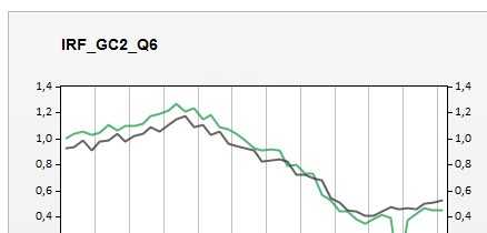

When I use my own copy of EViews 14 and run an add-in to format a graph object that includes the following command:
{%gr}.options size({!width}, {!height}) frameaxes(lbrt) framewidth(0.5) gridwidth(0.5) gridcolor(ltgray) gridcust(year, 1) fillcolor(@rgb(255,255,255)) backcolor(@rgb(255,255,255)) color background backfade(none)
I get the expected graph, which is embedded in a spool object.
Skjermbilde 2025-11-15 104916.jpg (15.84 KiB) Viewed 32568 times

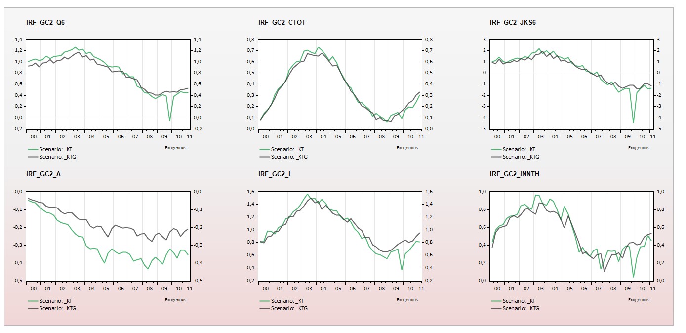

However, when EViews runs automatically on a server and calls exactly the same programs, the resulting graph is different.
Skjermbilde 2025-11-15 111519.jpg (15.1 KiB) Viewed 32568 times
In particular, the background fade effect (backfade) appears even though I specified backfade(none).
Why does the backfade behave this way on the server? Could there be some global setting or configuration in the EViews version on the server that overrides this option? What might be causing this difference?

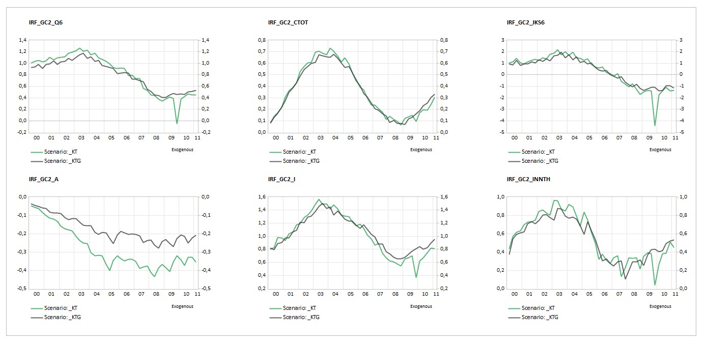

Postby tvonbrasch » Tue Nov 18, 2025 12:02 am
The problem persists even though each graph object in the multigraph is formatted with the code
{%gr}.options frameaxes(lbrt) framewidth(0.5) gridwidth(0.5) gridcolor({%gridcolor}) gridcust(year, 1) fillcolor(@rgb(255,255,255)) backcolor(@rgb(255,255,255)) backfade(none) color background.
Below is the image from running the program on my local EViews:
Skjermbilde 2025-11-18 080036.jpg (143.96 KiB) Viewed 32444 times

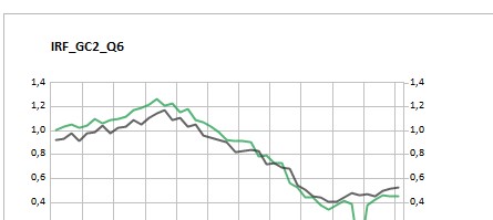

And this is the image produced when running the program automatically on the server version of EViews:
Skjermbilde 2025-11-18 075911.jpg (154.19 KiB) Viewed 32444 times
Is there a way to globally override the graph settings to ensure a white background for all graphs? Also, the horizontal gridlines are missing in the server version. Could this be a bug? (note that the multigraph is appended to a spool object)

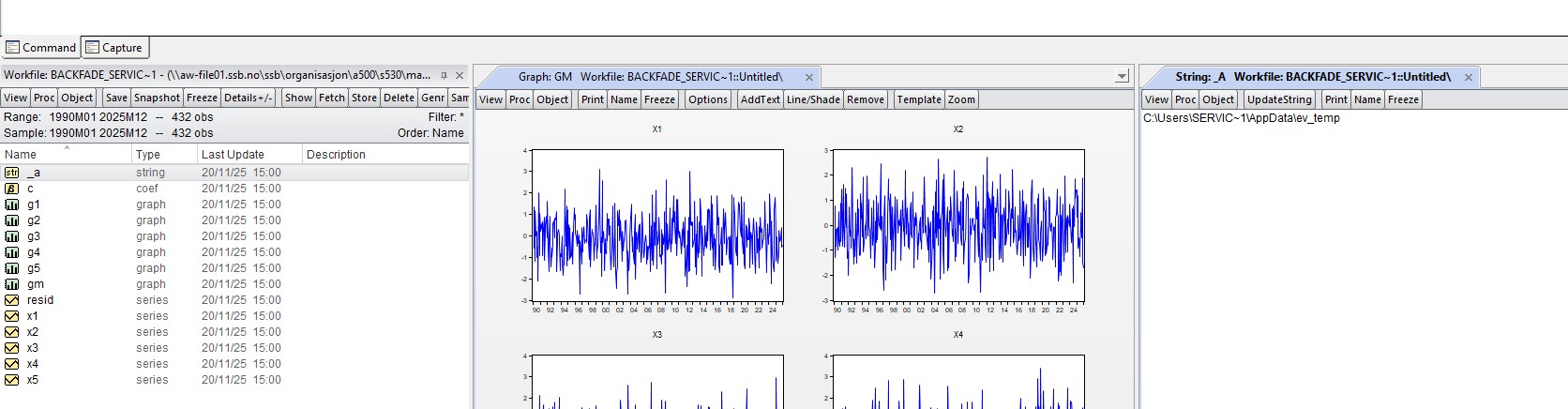

Postby tvonbrasch » Wed Nov 19, 2025 5:45 am
I had the IT department change the settings as suggested, but the background is still gray:
Skjermbilde 2025-11-19 134108.jpg (63.75 KiB) Viewed 32372 times
any other ideas for how I can change it to white?

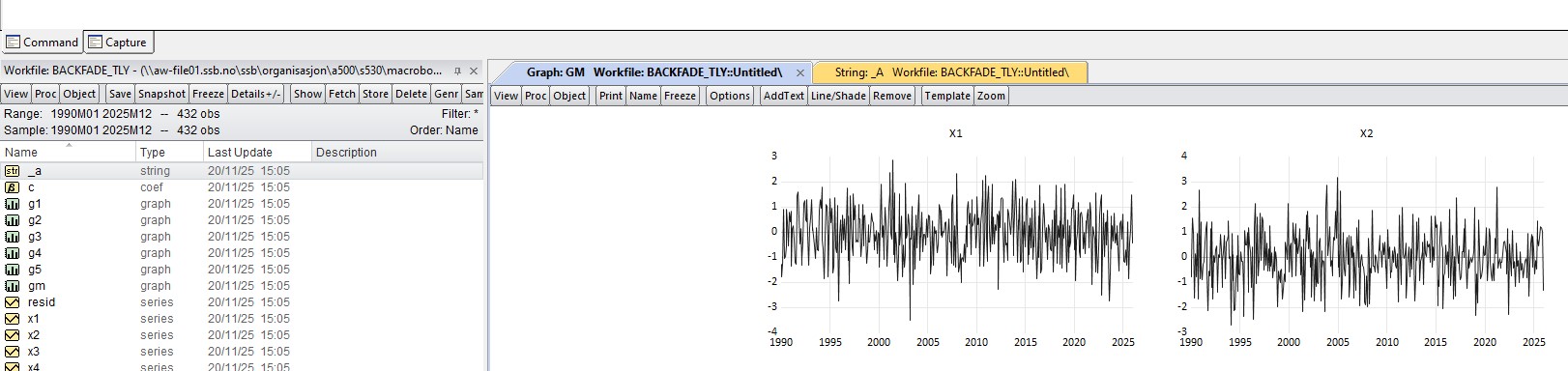

Postby tvonbrasch » Thu Nov 20, 2025 7:41 am
Thanks. I have updated the script running on the hourly server routine as follows:
'find username and store in string: %username %temppath = @temppath ' Get temp path 'finner strengen C:\Users\tly\AppData\ev_temp, og henter ut initialene "tly": !slash1=@instr(%temppath,"\",2) !slash2 = @instr(%temppath,"\",3) !diff=!slash2-!slash1-1 !start=!slash1+1 %username=@mid(%temppath,!start, !diff) %wf="backfade_"+%username wfcreate(wf={%wf}) m 1990 2025 for !I=1 to 5 series x{!i}=nrnd freeze(g{!i}) x{!i}.line g{!i}.options backfade(none) backcolor(@rgb(255,255,255)) next graph gm.merge g1 g2 g3 g4 g5 string _a=%temppath wfsave .\{%wf} wfclose {%wf}
When I execute this locally on my own version of EViews, the background renders as white, as expected:
Skjermbilde 2025-11-20 152721.jpg (135.73 KiB) Viewed 32280 times
However, when the server instance runs the script, it generates the following output:
Skjermbilde 2025-11-20 152614.jpg (151.04 KiB) Viewed 32280 times
This occurs even though IT has explicitly configured the graphic settings to use a white background.
Any suggestions on how to proceed to ensure the background renders correctly?
Re: backfade ?
Postby EViews Gareth » Thu Nov 20, 2025 8:52 am
Is the server's version of EViews up to date?
Also, I notice that your version also has the chart in black and white - is that expected?
Re: backfade ?
Postby tvonbrasch » Sun Nov 23, 2025 9:35 am
I followed up with the IT department regarding the issue. We previously had an old EV14, which they’ve now updated, but unfortunately, this did not resolve the backfade problem. As for my version, the black appears as expected.
