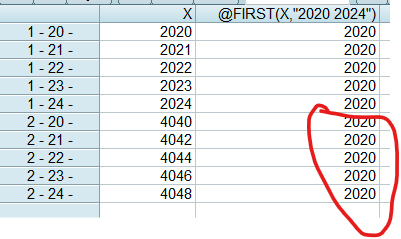

I suggest that you improve the @first(x) function to work proper in panels so that it allows for showing the first value of series x in each cross section in the preselected sample. To give an example, I would like to have an easy function which would show the value 4040 for x in the lines 2 - 20- until 2 -24- rather than the value 2020 in the program below.
Ideally, you would allow for an additional argument to the function @first to indicate the cross-sectional variable. So in the example below @first(x,"2020 2024", crossid) would show 4040 from 2 -20- onwards, whereas @first(x) would work as it does currently. Likewise, in panels with more than one cross ids, you would also implement @first such as to allow for @first(x, "2020 2024", crossid1, crossid2).
Best, mamo
wfcreate a 2000 2024 2 series x=crossid*@year smpl 2020 2024 show x @first(x)

@first returns a scalar, which is why it cannot be used to do what you want.

The function you describe already exists: @firstsby. For your example, I believe "@firstsby(x, @crossid)" would produce the results you want.

many thanks, indeed this works!
