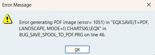

I have been running programs for years that ran this command, but now that I upgraded from v12 to v14, I am getting 2 errors. It often crashes eviews completely.
SpoolEQ.save(t=pdf, landscape, mode=i) chartsxl\EQ '<<< bug crashes here
I get 2 error messages, first this one
then this one
Let me know if you want the program and workfile so you can try it.
I tried playing with all of the options but none avoided the bug. I also tried creating the spool 2 different ways (print to output, and spool.append). Manually printing the spool using the Microsoft print to pdf driver works, but I think it looks a little different and I am not sure how to do that using code.

Could you provide the workfile and the save command you’re using?
Re: New bug saving spool of charts to pdf
Attached is a little program and workfile that should duplicate the problem.
I isolated the problem to one particular chart. The chart is supposed to have lines that are solid and dashed even if it is printed in color so it has a line that sets the option to linepat
graEQPE{%pfx}.options linepat
When that line is removed, the resultant charts do not crash the save to pdf command. When I add it back, the save command crashes.
Let me know if you want me to send you the code that creates the chart that is causing the problems. Here is a snip of some of the code that creates the problematic chart.
graEQPE{%pfx}.options linepat '<<< this line causes the save to pdf command to crash - removing it lets it run without errors.
Released a new patch with a possible fix.
Yes, the patch fixed the bug.
