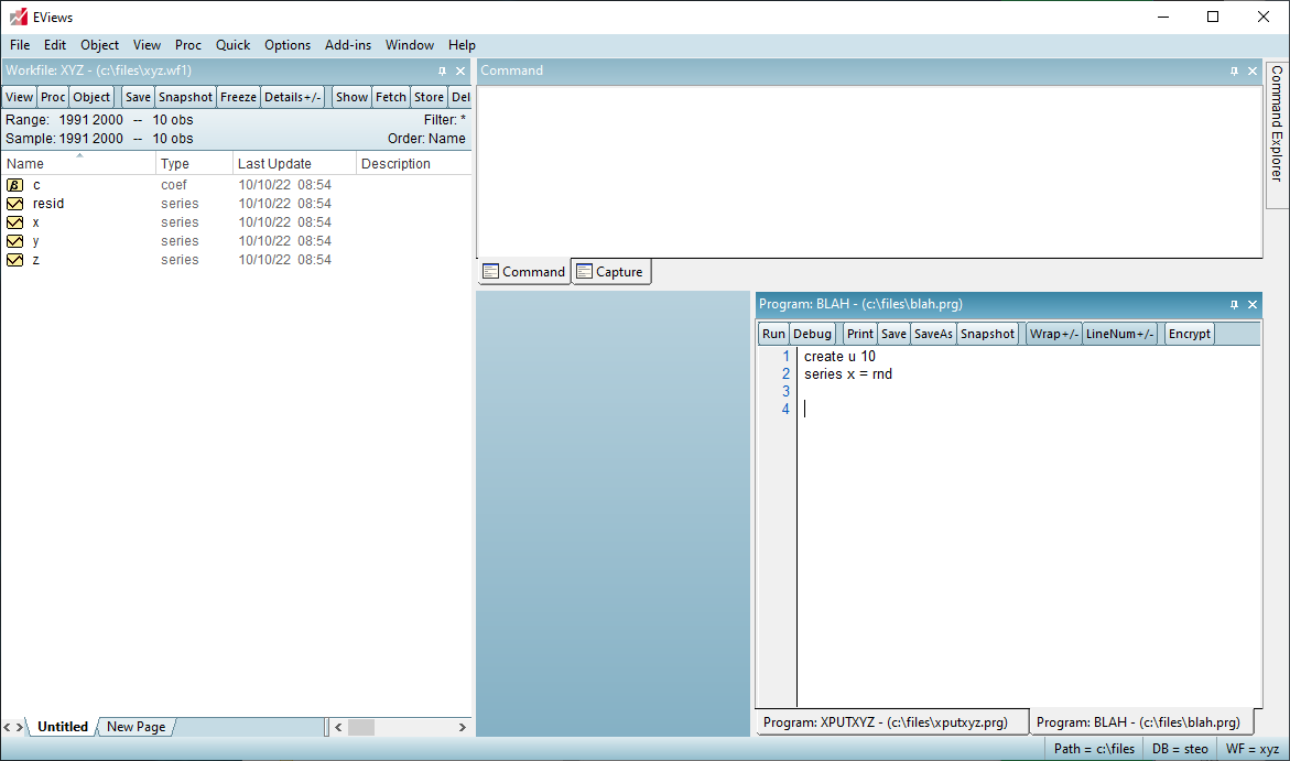

Docked panes can present themselves differently based on the order of docking. For example, since our command pane is usually presented first thing at the top of the EViews frame, when you open a workfile that is docked to the left, this window only starts below the above command pane. If done in reverse order, the workfile would take the entire left side and the command window would take less space, like in the following screenshot.

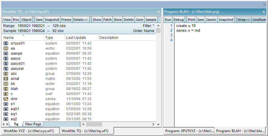

Also, panes can be infinitely grouped together in any number of tabbed containers, and each tabbed container can also be docked separately. For example, you can create a floating window like this with 2 workfiles and 2 programs:
And since you can only open one window at a time, I'm not sure how you would programmatically create the window above just the way you want it. Plus there's the fact that my example above shows the workfile panes using 2/3 of the space compared to the program panes.

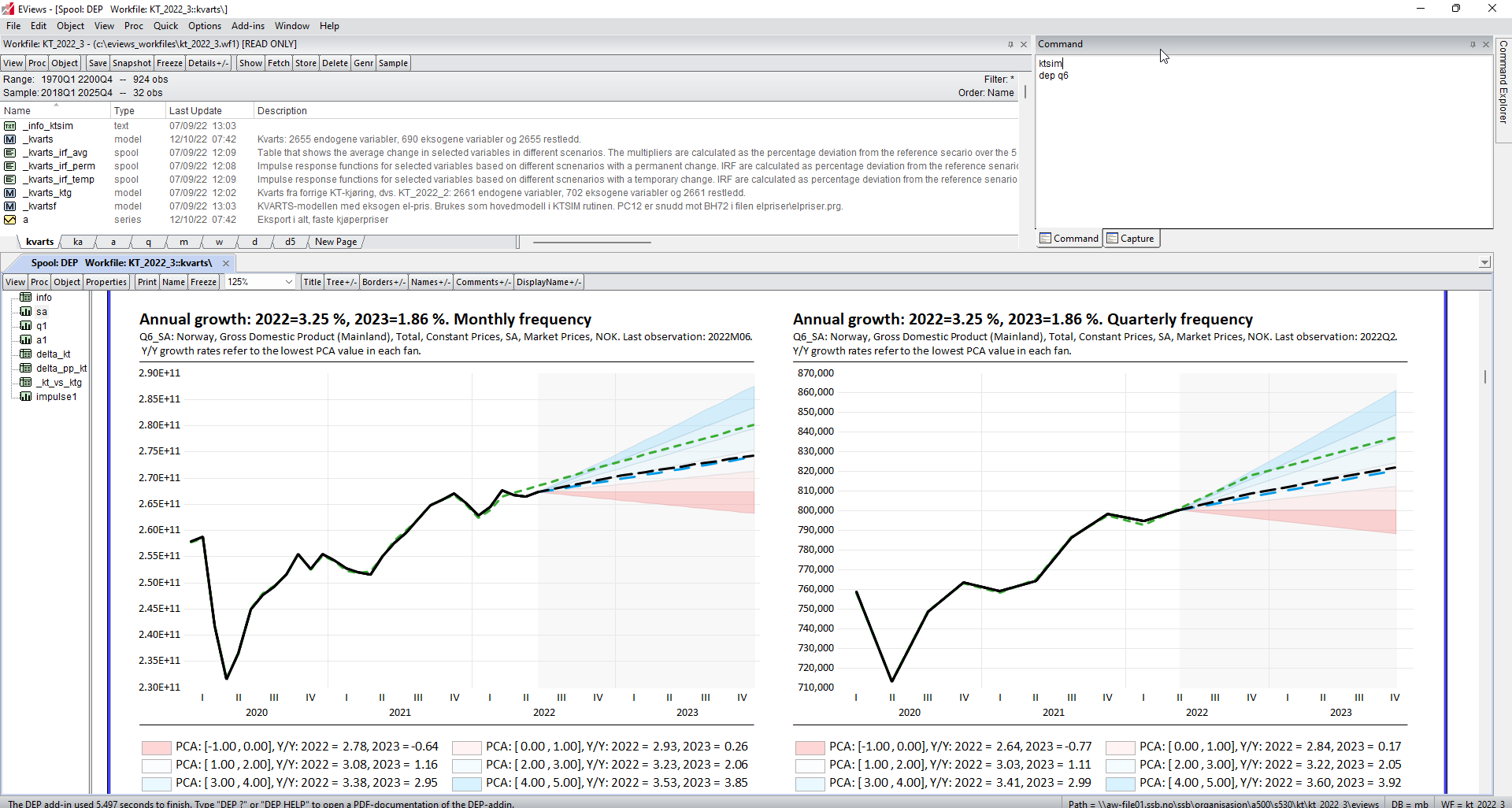

In the default setting, my view looks like this:
2022-10-12 07_43_34-Innstillinger.png (142.3 KiB) Viewed 63233 times

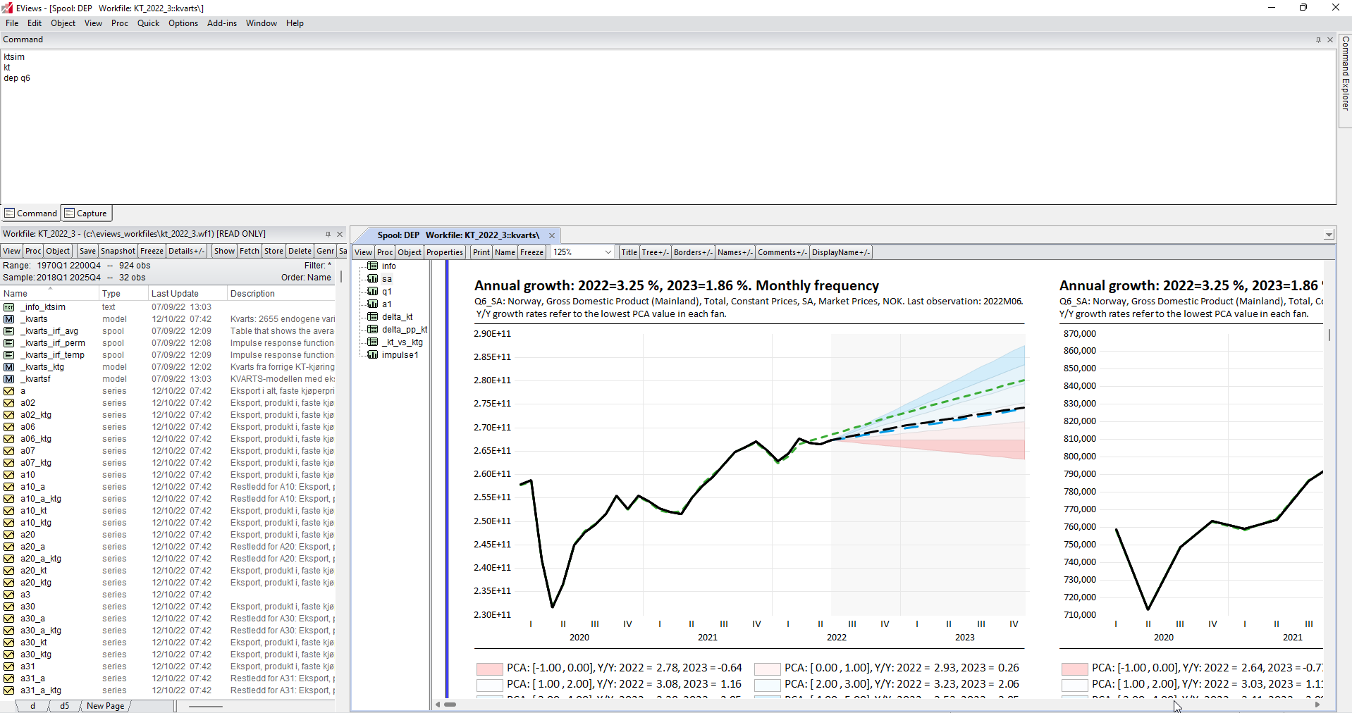

Since all our add-ins are made based on the spool object using the entire width of the window*, and since the command pane does not need to be as wide as in the default setting, I would prefer a layout like this:
2022-10-12 07_44_40-Innstillinger.png (144.98 KiB) Viewed 63233 times
Would it be possible to provide such a layout among the main options to choose from?
That would be highly appreciated!

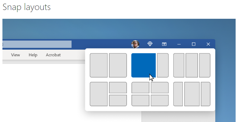

- Maybe you could even allow the user to snap between the different modes using e.g. the CTRL key and arrows: https://forums.eviews.com/viewtopic.php?f=8&t=21372
