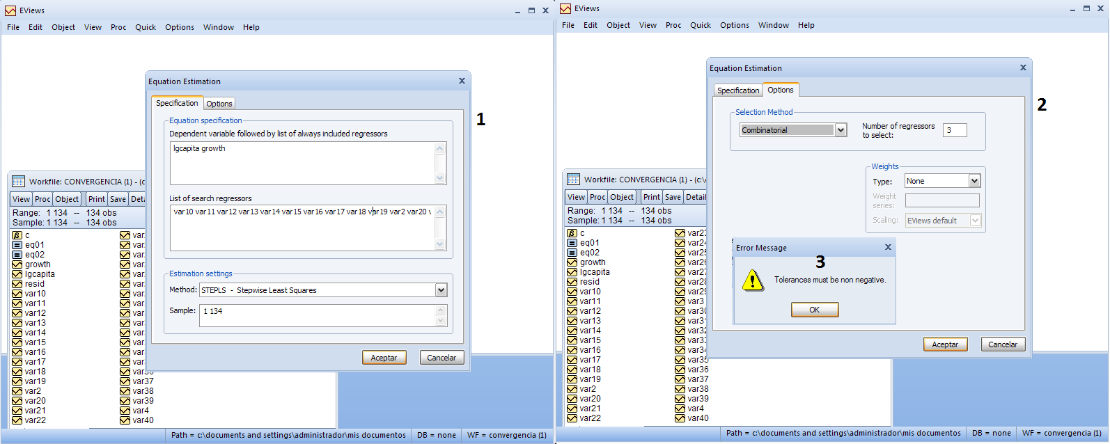

So, You were able to do it? Could I ask you how?
I still got Tolerances must be non negative.... what i'm doing worng??
I will attach the image with my selected options.
what's wrong.PNG (76.06 KiB) Viewed 8922 times
Posts: 13603
Re: Find Highest Squared R
Postby EViews Gareth » Sun Mar 28, 2010 7:33 am
Switch the method to "Stepwise" and ensure you have positive numbers in the stopping criteria. Then switch back to combinatorial.
arucard_esp
Posts: 5
Joined: Sat Mar 27, 2010 1:24 pm
Postby arucard_esp » Sun Mar 28, 2010 10:17 am
Oh great thank you so much!! I finally managed to do it! :)
