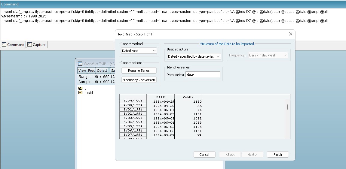

So weird. I'm using EV13, 8 Jan build, which is the latest update, as per what I noticed. I keep getting a prompt as per the screenshot below :( I'm trying to figure out what is happening, too. :?:

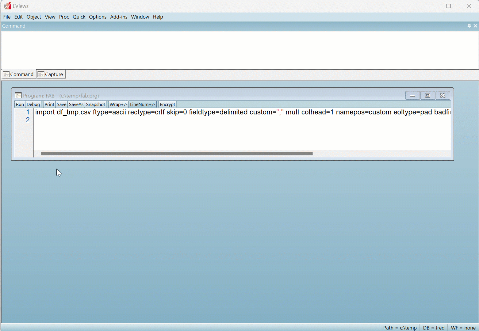

Try running it in an program, not as a command.
fmramos
Posts: 116
Joined: Fri Sep 19, 2008 7:30 am
Location: Sao Paulo / Brazil
Re: Importing data from .csv files, prompt and matched dates
Postby fmramos » Tue Feb 06, 2024 4:31 pm
It worked :)

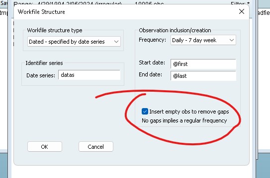

I (think I) figured out what was going on. It works if the import process happens as an irregular file. So... I Need to regularize after. The series I get is mostly 5 (trading) days/week, but sometimes we have 7 days/week with empty cells, and some days with 5d/week with NA... So... The app can't read data as regular. The clash of regular vs. irregular data might cause problems. Better to add pagestruct(reg) for tons of series with daily data.
Well, a problem with data series standardization...

Postby EViews Gareth » Tue Feb 06, 2024 4:35 pm
More specifically, when issuing a command, EViews presumes you're sat there willing to input something, so if there is a doubt about what's going on, EViews is more willing to prompt you with some options.
If you're running a program, EViews assumes you don't want to be prompted, so goes with a default.

Image below.Tks.
