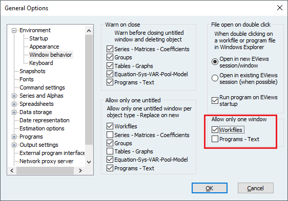

In the meantime, you can prevent the duplicate workfile window from being opened by asking EViews 13 to prevent duplicate workfiles from being opened. To do this, go to the Options menu/General Options/Environment/Window Behavior and checking the "Workfiles" checkbox under "Allow only one window".

Thanks! That solved the issue for now
