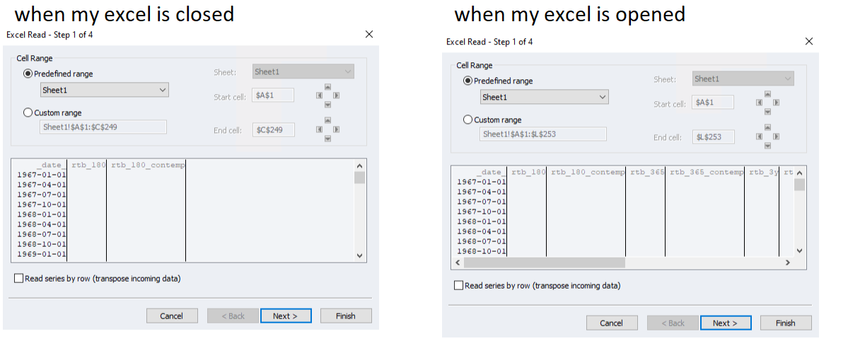

I'm trying to import an Excel file through drag and drop and the results differ whether I have the Excel workbook open or not.
When I have it closed, only 2 of the 11 series are loaded. When it's opened, all 11 series load fine.
loading via drag and drop
eviews excel.png (54.08 KiB) Viewed 51649 times

Postby EViews Gareth » Fri Dec 22, 2023 10:07 am
In the first screenshot, change the Range to custom:
Sheet1!A1:l253

Postby houji » Fri Dec 29, 2023 1:22 pm
Thank you, that worked.
