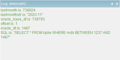

logmode l !lastmonth = @dateadd(@datefloor(@now, "mm"), -1, "mm") logmsg lastmonth is: !lastmonth '738824 %lastmonthstr = @datestr(!lastmonth, "yyyy:mm") logmsg lastmonthstr is: %lastmonthstr '2023:11 !oracle_base = 1486 !oracle_base_dt = @makedate(2023.10, "yyyy.mm") logmsg oracle_base_dt is: !oracle_base_dt '738793 'count how many months since oracle_base_dt !offset = @datediff(!lastmonth, !oracle_base_dt, "mm") logmsg offset is: !offset '1 !oracle_dt = !oracle_base + !offset logmsg oracle_dt is: !oracle_dt %sql = "SELECT * FROM table WHERE mdb BETWEEN 1237 AND " + @str(!oracle_dt) logmsg SQL is: %sql pageload(type=odbc, timeout=900) c:\files\test.dsn %sql
My log window after running:
