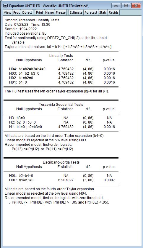

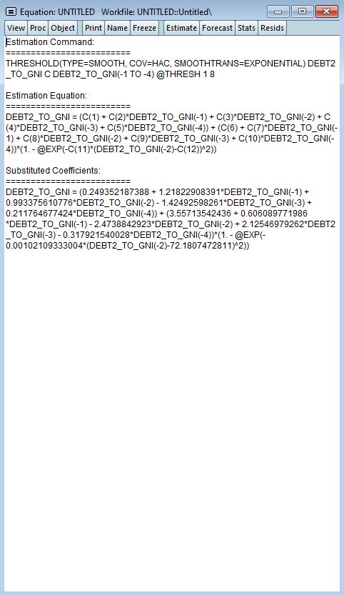

Hi all,
I have three questions on STAR output.
I've estimated a univariate ESTAR model with 4 lags on both linear and non linear parts and a delay of 2 in both EVIEWS and R Studio. All coefficients are the same apart from gamma (R Studio gamma is 1.1359, std error 0.3610, sigma2 of model 23.256613). I know there is an issue with standardising gamma but I think it should be possile to convert by hand by scaling with the std dev fof the dep var, but nothing seems to come close? Can anyone help here?
When performing the linearity tests some of the p values are reported as NA. Can anyone explain this?
Also, with the same tests, the f statistics are the same for several hypothesis tests. Why is this?
All relevant details in the attachments below.

You'll need to post your workfile.

Thanks Rebecca, the brackets were causing it to crash. Stupid of me.
Can you comment on the NA issue and the F stats?

For the F stats: we're looking into it. Current thinking is there probably aren't enough observations for some of the tests.
