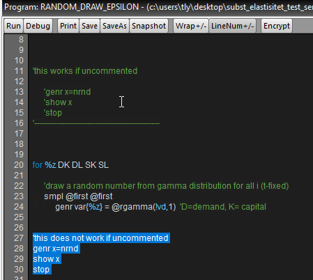

is included at the top of the master-file. The random numbers in X are generated in the program file: ces_mone_carlo\random_draw_epsilon.
If we rerun the program files on the same computer, the same random numbers are generated. However, if we run the exact same files on a different computer, a different set of variables are generated. What is strange, is that if we move the generation of the series X to lines 13 to 15 in the program (from lines 27 to 29), the program generates the same random numbers in the variable X, even when executed from different computers.

It appears that you're experiencing a "normal" EViews behavior involving random number generation. A sequence of random numbers generated as part of a series expression is dependent on both the state of the underlying random number generators (influenceable via the 'rndseed' command) and the number of threads used to generate the series (influenceable via the Options -> General Options -> Advanced system options -> "Maximum threads used in statistical calculations" setting). If the later setting differs on two machines, different results may be produced even when 'rndseed' has been issued. You can set the maximum number of threads to 1 on both machines to force generation of consistent random sequences. Alternatively, the next patch will include a new setting to intelligently disable multithreading in the presence of random number functions, allowing the other thread setting to remain as is.
