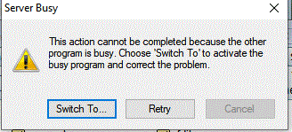

– I am working on a database in EViews that uses an external interface to R to perform certain tasks such as extracting data from Eurostat or performing transformations either not available or very difficult in EViews.
I keep getting the attached message however when doing this. The task is usually successful but I sometimes will wait 30 mins or so – even for relatively small transformations. Other times it will just crash EViews.
Has anyone else had this issue? It is the same on and off my organisations VPN so I don't think its a network issue.
The version is EViews RConn x64 (R Version 4.1.1) so was thinking it might be an update issue?

The "Server Busy" dialog will appear when Windows COM (used by EViews to talk to R in this case) doesn't hear back from R within a certain time frame (I believe 60 seconds is the default).
If you want EViews to wait forever during it's calls to R, you can use the COMTIMEOUT command (introduced in EViews 10) to set the timeout value to zero BEFORE you call XOPEN, like this:This should prevent the "Server Busy" dialog from appearing.
Now as to why your R call is taking longer than 60 seconds, you'll have to debug that on the R side. The most likely reason is because Eurostat itself is busier at certain times than others. So if your R code is downloading data from Eurostat, then that's where I would look first. Try writing to an external log file (or the console) both before and after the download so that you can see how long various steps are taking.

Hi Steve - Thanks for getting back to me on this. It doesn't seem to work no matter what the function is. Even this simple example of seasonal adjustment stalls and displays the same message. And in this case just stays busy without carrying out the command.
Here are details you asked for.
Your EViews version and build date: EViews 12 and March 3 2021
Your R version and bitness: R Version 1.4.1717 (64 bit)

No worries Gareth - here is a more staright forward command. Just one variable from Eurostat which again stalls and can take up to 30 mins due to server busy issue.

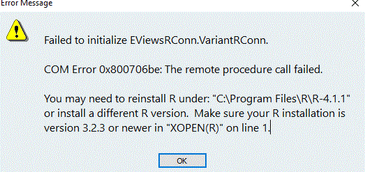

Just an update question - I have updated R to the most recent version (R version 4.3.0). Now when I run xopen(r) I get the below message.
Any idea how to resolve this?

- Posts: 3798
Re: Trouble with RConn
Go to options/General options/External program interface and change the path.

Just to update the Updated R Version 4.3.0 has same issue. Server busy message appears and can be 30 mins plus for even a single series.
