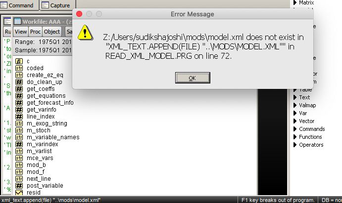

I was running the eight program files that are in the FRB/US package using Eviews11. They are in the "programs" folder and contain the simulation commands. After a few modifications in codes, I was able to run about halfway in all those files, when I came across one strange error that is inhibiting me to see the simulation results in all the eight files. The error message is the same all across the files.
Error path file.png (75.97 KiB) Viewed 29160 times
"read_xml_model.prg" is found in the "addins" folder in the package.
I would appreciate it if anyone can help resolve the error.

Postby EViews Gareth » Thu Jun 04, 2020 10:49 am
Might be a Mac issue.

Oh, how exactly is it a Mac issue? Does it mean that I have to use a computer with a Windows OS to run the simulations without encountering this specific and related errors?
Re: Error in using FRB/US model in Eviews 11
Postby EViews Gareth » Thu Jun 04, 2020 1:18 pm
Possibly. I don't have a Mac to hand to test, but it is unlikely that the Fed uses a Mac.

It just occurred to me that this may be a simple working directory issue, as the FRB/US programs are written under the assumption that the working directory is that package's "programs" directory. If that's the problem, just set the working directory accordingly (double-click the "Path = " area in the lower right of the EViews window) and you should be good to go.

Postby joshi27s » Fri Jun 05, 2020 2:24 pm
Thanks, Matt. This helped me to resolve the error :)
