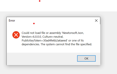

I am new to Eviews forum and not too sure if this is the right way to post an issue. I have been getting this "could not load file or Assembly"error(screenshot attached) when using BLS and BEA API through eviews. Has anybody experienced the same thing? thanks
Screenshot 2024-06-18 124440.png (28.48 KiB) Viewed 59113 times
Posts: 13612
Re: Foreign Database, BLS, limiting out well below 500 query limit
Postby EViews Gareth » Tue Jun 18, 2024 11:02 am
Version and build date of EViews? (Help->About EViews)
Postby EViews Steve » Thu Jun 20, 2024 8:42 pm
There was a BLS dll issue that was introduced recently. This problem has been fixed in the latest 13 patch.
