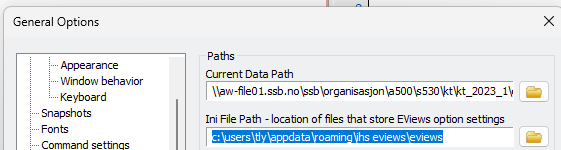

Postby tvonbrasch » Fri Jan 20, 2023 1:10 am
great, thanks!
is there a command for retrieving the ini file path? (such as @inipath)
2023-01-20 09_06_16-General Options.png (9.55 KiB) Viewed 58616 times
