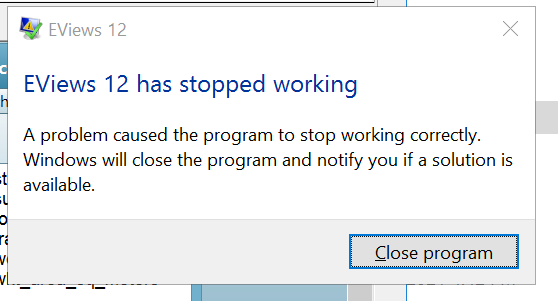

I got a dilemma here. I have tried to increase the alpha truncation, and it works well for some of the files. But when it comes to some files, Eviews always stopped running. (See the screenshot). I have then tried to reduce the alpha truncation from 8000 to 7000 (then reducing all the way to 500); more files can pass thru, given I set a lower truncation value. However, in any case, as long as I go more than 200, the programme stops running at some points. From my trial, I think it needs at least 5000-6000 to ensure most of the variables couldn't mess up.
Can I try to import the csv without those polygon variables? Will it avoid the problem?
Grateful for your advice on how I can solve this dilemma, as I really want to use Eviews to continue my analysis. Many thanks in advance.

Postby EViews Gareth » Wed Dec 28, 2022 11:40 pm
Yes, you could drop that variable if you don't need it.
wfopen poi_testing.csv @drop polygon_wkt
