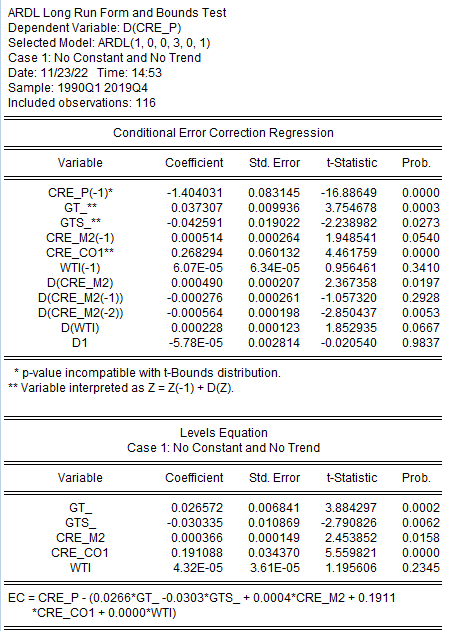

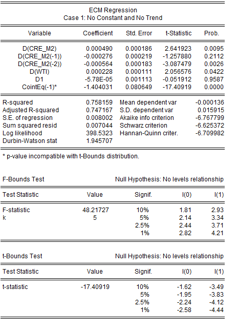

Hello everyone, pls I need your help with the estimation of an ardl model in eviews 12. The next output is an ARDL regression with the most important variables being GT and GTS. As you can see none of them appear in the ECM regression so I am wondering if none of them are actually significant in the short and long relationship with the dependent variable CRE_P.
Also what does it mean that the CointEq (-1)* p-value incompatible with t-bounds distribution
