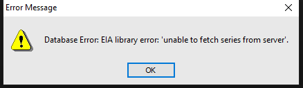

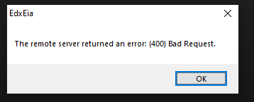

Postby amrsherif » Tue Feb 15, 2022 7:49 am
I am having trouble with EIA's database again (please see the below snapshots). It seems like they've made changes, but i cannot be sure. Any idea what is going on?

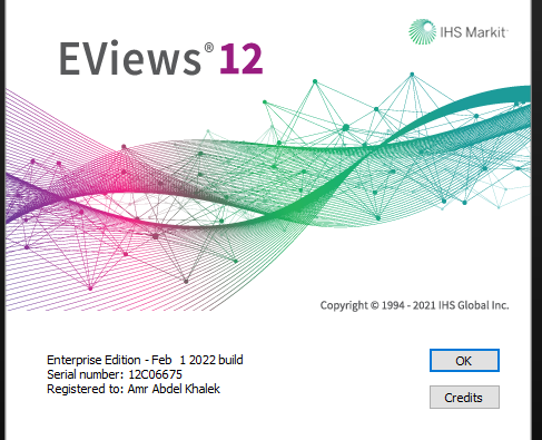

I am using EVIews 12 Feb 1 2022 edition

Same issue, Eviews 11.
It would seem that the EIA has disabled HTTP access and now requires HTTPS connections only.
https://www.eia.gov/opendata/register.php
Notice: As of February 11th, 2022: The API now only respond to HTTPS. Insecure (HTTP) web protocols are no longer supported.

Postby EViews Gareth » Tue Feb 15, 2022 4:06 pm
EViews 12 patch addressing this has been released.
