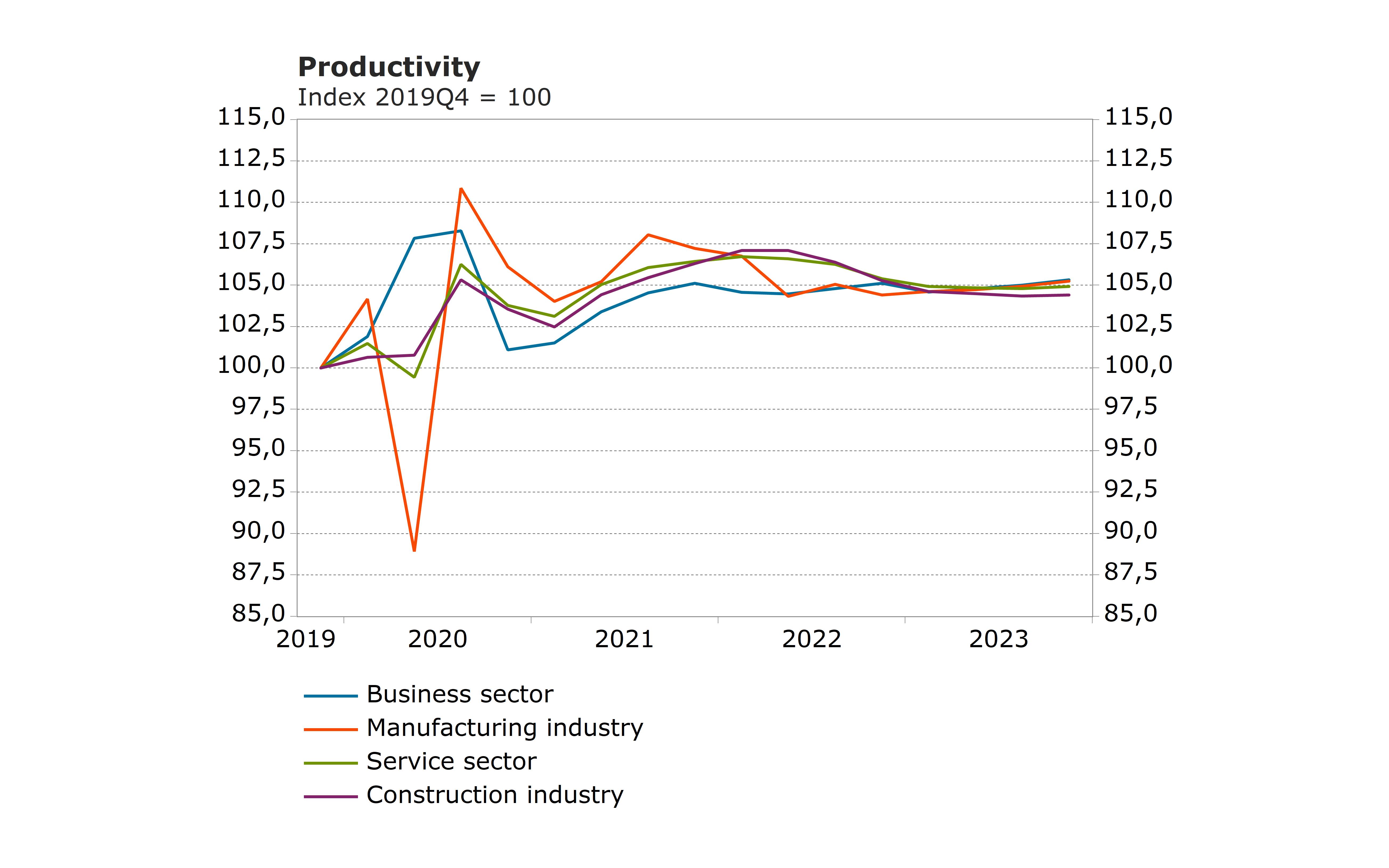

Hello
Our company uses Eviews graphs both for internal use and external publication and powerpointpresentations. We use emf-images because they provide a sharper image.
In Eviews 12 the graph looks fine.
In Eviews 13, however, there has been something wrong with the positioning of the various elements. The text in the header and subheader appears too dense, the chart area extends over the left x-axis, and the labels end up too far to the left and overlap the label lines.
See the attached pdf-file and code if you want to test it yourself.
Best regards Johan
Graph.pdf
(116.04 KiB) Downloaded 1285 times
WfCreate(page=Q) Q 2019q4 2023q4 Call Data %p = @LinePath !ver = @VerNum PageSelect Q Group group1 n* Freeze(G1) group1.mixed line(1) line(2) line(3) line(4) G1.name(1) Business sector G1.name(2) Manufacturing industry G1.name(3) Service sector G1.name(4) Construction industry G1.addtext(0, -0.65,Just(L),textcolor(@rgb(40, 40, 40)),Font(Verdana,18,B))Productivity G1.addtext(0, -0.35,Just(L),textcolor(@rgb(40, 40, 40)),Font(Verdana,16))Index 2019Q4 = 100 G1.axis(b) -minor G1.axis(b) angle(0) G1.axis(b) font(verdana,16) G1.axis(l) range(85,115) G1.axis(l) mirror format(commadec, -ksep, leadzero) G1.axis(l) font(Verdana, 16) G1.axis(r) mirror format(commadec, -ksep, leadzero) G1.axis(r) font(Verdana, 16) G1.axis dual G1.datelabel format(YYYY) G1.options size(7.36,4.6) G1.options linepat G1.options -barspace G1.options backfade(none) fillfade(none) backcolor(white) framecolor(white) -background G1.options backfade(none) fillfade(none) backcolor(white) framecolor(@rgb(128,128,128)) -background G1.setfont legend(verdana, 16) G1.legend display G1.legend position(bl) font(verdana, 16) -inbox columns(1) G1.options gridnone G1.options gridl gridpat(dash6) gridcolor(gray) gridwidth(0.5) -gridontop G1.setelem(1) linewidth(2) linepattern(1) linecolor(@Rgb(0, 112, 158)) fillcolor(@Rgb(0, 112, 158)) fillhatch(1) G1.setelem(2) linewidth(2) linepattern(1) linecolor(@Rgb(247, 73, 2)) fillcolor(@Rgb(247, 73, 2)) fillhatch(1) G1.setelem(3) linewidth(2) linepattern(1) linecolor(@Rgb(112, 147, 2)) fillcolor(@Rgb(112, 147, 2)) fillhatch(1) G1.setelem(4) linewidth(2) linepattern(1) linecolor(@Rgb(132, 33, 107))fillcolor(@Rgb(132, 33, 107)) fillhatch(1) G1.save(t=Emf, u=cm, w=22.08, h=13.8, trans) {%p}graph_{!ver} G1.save(t=Jpeg, u=cm, w=22.08, h=13.8, -trans, d=600) {%p}graph_{!ver} '_____________________________________________________________________________________ Subroutine data Series Nprtjvebpfsi Series Nprnbpfsi Series Nprindubpfsi Series Nprbyggbpfsi Nprtjvebpfsi.Fill 100.00, 100.65, 100.77, 105.33, 103.56, 102.47, 104.42, 105.46, 106.31, 107.09, 107.10, 106.39, 105.27, 104.62, 104.48, 104.35, 104.40 Nprnbpfsi.Fill 100.00, 101.48, 99.43, 106.25, 103.78, 103.12, 105.03, 106.06, 106.43, 106.72, 106.60, 106.25, 105.39, 104.92, 104.84, 104.80, 104.92 Nprindubpfsi.Fill 100.00, 104.17, 88.92, 110.85, 106.11, 104.02, 105.21, 108.05, 107.23, 106.75, 104.32, 105.05, 104.41, 104.62, 104.73, 104.94, 105.25 Nprbyggbpfsi.Fill 100.00, 101.90, 107.83, 108.29, 101.10, 101.51, 103.39, 104.53, 105.11, 104.57, 104.47, 104.79, 105.11, 104.58, 104.79, 105.00, 105.32 EndSub

In EViews 13, we've added the ability to set line and bar opacity. By default this is on. This has a very noticeable effect on the emf graphs. With opacity on, lines become dashed lines. To turn off, opacity in your program use:
g1.setelem(1) lineopacity(OFF,0.75) g1.setelem(2) lineopacity(OFF,0.75) g1.setelem(3) lineopacity(OFF,0.75) g1.setelem(4) lineopacity(OFF,0.75)
With that being said, even with it opacity on, we could not generate the EViews 13 image in your PDF where there appears to be an extra frame/box that overlaps the y-axis label and the legend text overlaps with the legend lines.

Ok then the graph in Evews 13 will be ok, i.e. if I put
But I don't really understand the command, why are there two arguments, according to "Command Reference help" it should only be one argument and a value between 0 and 1, i.e.
g1.setelem(1) lineopacity(1)
Can't find anything written about "OFF" as an argument?
But whether the lines are transparent or not shouldn't affect the placement, so feel free to continue investigating this.
Another thing, using the same code as before also creates a jpg-file. There will be a relatively large white area around the graph. Is it possible to shrink that surface so that the image only shows the diagram itself. See
Regards Johan

Unless one sets lineopacity(OFF), exporting a line chart to EPS (with the Proc - Save graph to disk command) produces an empty chart - no lines are visible. This does not seem to be intended behavior. Using Eviews 13 Oct 11 build.

The docs are wrong and we will get it corrected. The docs should read
Lineopacity(arg) where arg is the mode and/or the opacity value. Three acceptable values for mode are ON, OFF, and AUTO. Opacity value can be an value from 0 to 1.
Setting the level to 0.0 or setting the mode to OFF will make the object completely transparent (0% opacity) while a value of 1.0 (assuming the mode is ON) will make the object completely opaque (100% opacity).
Examples:
mygraph.setelem(1) lineopacity(off) 'turns off line opacity mygraph.setelem(1) lineopacity(on) 'enables line opacity whereby the opacity value does not change mygraph.setelem(1) lineopacity(on, 0.5) 'enables line opacity and set the opacity value to 0.5 mygraph.setelem(1) lineopacity(0.5) 'set the opacity value to 0.5. But depending on the current mode may not have any visual effect
In regards to the jpg whitespace, some of it can be removed by adjusting the size. EViews will not change the aspect ratio graphs. It will look for the limiting dimension whether that be width or height and then size accordingly.
In your example you have:
and this creates a graph with a lot of whitespace on the sides. By just lowering the width:
G1.save(t=Jpeg, u=cm, w=20.08, h=13.8, -trans, d=600) {%p}graph_{!ver}
you will get less whitespace.

The EPS issue will be fixed in the next patch
