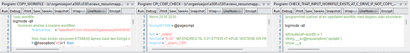

I would like all my programs to open in tabs mode, i.e
2022-10-11 14_16_07-EViews.png (9.93 KiB) Viewed 3127 times
However, even though I have the "remember previous"-option activated, when loading several program files, they open in different panes ...
2022-10-11 14_17_42-EViews.png (26.1 KiB) Viewed 3127 times
How can one instruct EViews to open programs in tabs mode only?
