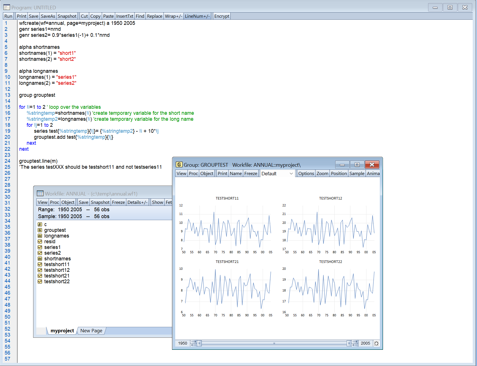

Not sure I follow. If I run your code I get this:
Which seems to be what you think should happen?
As an aside, you should probably be using svectors rather than alphas.

Thank you for having a look.
For some reason, it did not run correctly on my machine. It does now.
