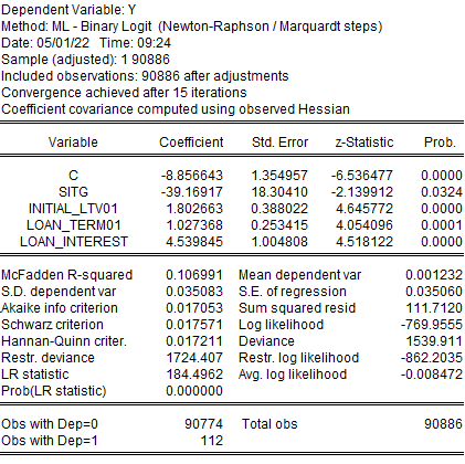

I just played around with the variables and tried making some variables as dummy variables (loan to value % and loan term(short term & long term)) and left the rest 2 variables that were in % as quantitative. In addition, I also generated a series and named it y=default status. I m not sure how, but I got the regression results after doing this. I have attached a screenshot. However, Mcfadden r squared is only 0.10. Is this because it is the log likelihood? I had 2 other variables that I wanted to add but it gives me a "quasi separate completion error".

- Posts: 3798
Re: Dependent variable has no variance - Logit regression
One possibility is that in the original specification there was a lot of missing data for the right hand side variables, eliminating all the 1's.
