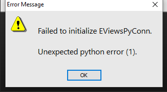

I am trying to run xopen(p) on my colleague's machine, and we are getting this error when we type xopen(p) in the command (also see attached photo):
Failed to initialize EViewsPyConn.
Unexpected python error (1)
Any chance this is a common error with a known solution?
It works on my other two computers
I have set the python path correctly in EViews' options

Try running the REGCOMPONENTS command to re-register all EViews components. Once done, try the XOPEN call again.
If you continue to run into issues, please provide the following details:
1. Path to your python home
2. Python version you are trying to use
3. 32-bit or 64-bit python?
4. Generic Python or Anaconda Python?
5. EViews version and build date.

I was trying python 3.10
I just downlaoded 3.7 (which is the version working on my PC) and it works.
Could you tell me the latest version of python that works with EViews?

We've been using EViews with python 3.9 successfully.
But I've verified that 3.10 does seem to have the problem you reported. My guess is that the public interface in python310.dll has been changed significantly.
We will look into it.

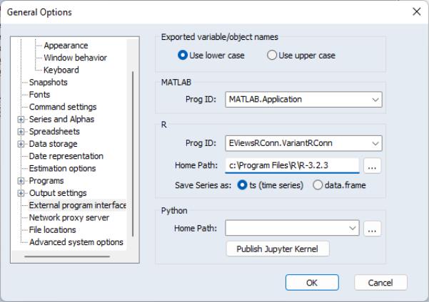

- Posts: 846
- Location: Irvine, CA
Re: failed to initialize EViewsPyConn
Have you checked the python path you're using within EViews?
Go to Options menu/General Options/External program interface. Double-check the "Home Path" value for Python. Make sure that folder is still valid and also contains an actual "pythonX.dll" (e.g. python3.dll). Also, go to that folder and see if you can actually run python.exe from that location to make sure it's installed correctly.
