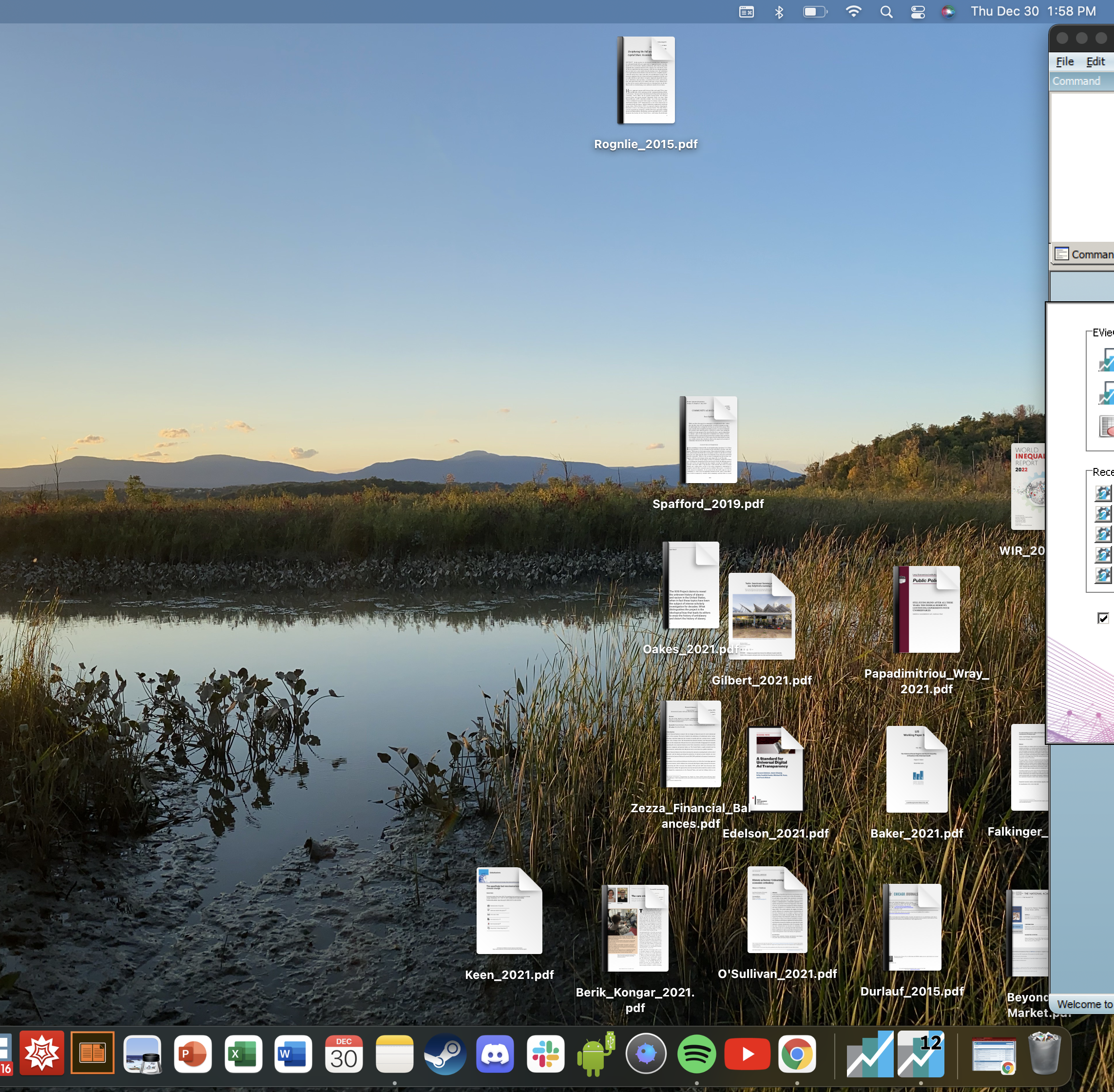

I am unable to open Eviews 12 University on my MacBook Pro running macOS Monterey Version 12.0.1
I have attached a screenshot showing what happens when I try to open EViews - the EViews window opens to the side of the desktop and I am unable to click anything in the EViews window
I have tried removing and redownloading/installing EViews University to no avail
Thank you for your assistance
Screen Shot 2021-12-30 at 1.58.57 PM.png (6.69 MiB) Viewed 77211 times

Postby EViews Jason » Thu Dec 30, 2021 5:11 pm
Press command+space to bring up the spotlight search. Then type terminal. Select the Terminal app. In the Terminal window, you will see a prompt of the form username@computername (for example: jsmith@johns-Macbook). Make note of the username. In this example, username is jsmith.
In the Terminal type
cd .wine/drive_c/users/username/Application\ Data/IHS\ EViews/EViews
(but replace username with the one from the previous step)
Using the example, the command would be
cd .wine/drive_c/users/jsmith/Application\ Data/IHS\ EViews/EViews
Next press Enter. If you do not see an error message, the command was entered correcty.
Next type
rm EViews32.ini
Try starting EViews
