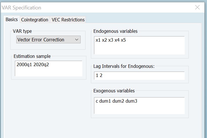

When estimating a VEC model, EViews allows you to specify dummies as exogenous variables as shown in the attachment. But these dummies will be unrestricted, outside the cointegration space. I need to specify dummies as restricted to cointegration relations. I know both RATS and JMulTi have that option but can't seem to find a way to do it in EViews.
VEC spec.jpg (49.46 KiB) Viewed 10327 times

Unfortunately, at the moment those types of exogenous variables are not permitted. This is an active area of work and we hope to have something soon, but I'm sorry that we can't support you at the moment. Please let us know if you have additional features you would like.
