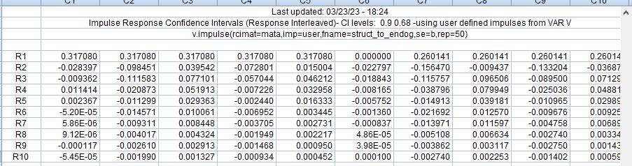

I had a concern regarding rcimat with bootstrap, Eviews13
It seems that the series are not in order. The responses are interleaved between the confidence intervals, so it is hard to use the matrix to manually create charts.
create u 50
series x = rnd
series y = x + rnd
series z = nrnd
var v.ls 1 2 x y z
matrix struct_to_endog = @cholesky(v.@residcov) ' The structural factorization matrix
freeze(temp) v.impulse(imp=user, fname=struct_to_endog, se=boot, bs = sp, rep=50,cilevels = "0.68 0.9",rcimat = mata) ' Reference multigraph
- Untitled1.png (22.93 KiB) Viewed 13531 times

What chart do you wish to create? The interleaving is chosen specifically to make it easier to create standard charts.
