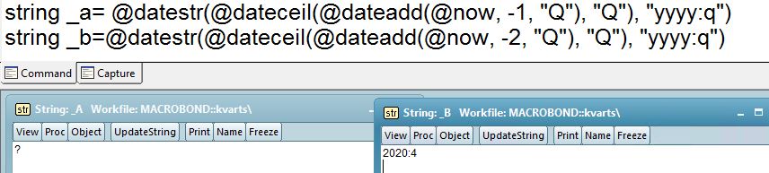

Postby tvonbrasch » Sat May 29, 2021 9:55 am
why does the string _a return a question mark?
t
Re: String dates: the last day of x-quarters ahead
Postby EViews Gareth » Sun May 30, 2021 9:00 am
A quarter is 3 months.
Subtracting a quarter from 29th May (which is when I assume you did the operation, given that's when you posted the question), yields a result of 29th February. 29th February doesn't exist. So the result is an NA.
