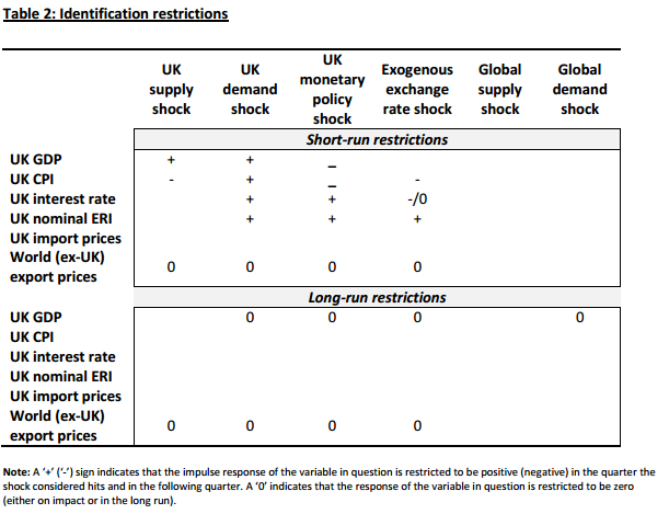

I am trying to recreate an SVAR from a paper by Forbes, Hjortsoe & Nenova (http://www.bankofengland.co.uk/monetary ... er0043.pdf[/url]) but I need some help with the restirctions. I know what they are supposed to be (see image) but I am struggling to put the code together. I have used the help guide on SVARs but have not made much progress.
If anybody could lend a hand it would be greatly appreciated.
(Eviews version 9, all variables in the same order as presented in the table).
Thanks very much for any help

You cannot. It is combination of parametric (short and long run zero type) and sign restrictions. There are 2 add-in that separately handle parametric and sign restrictions: the svarpatterns add-in, the srvar add-in.
