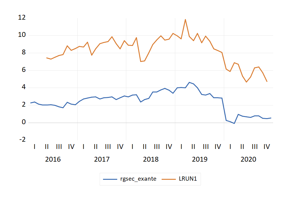

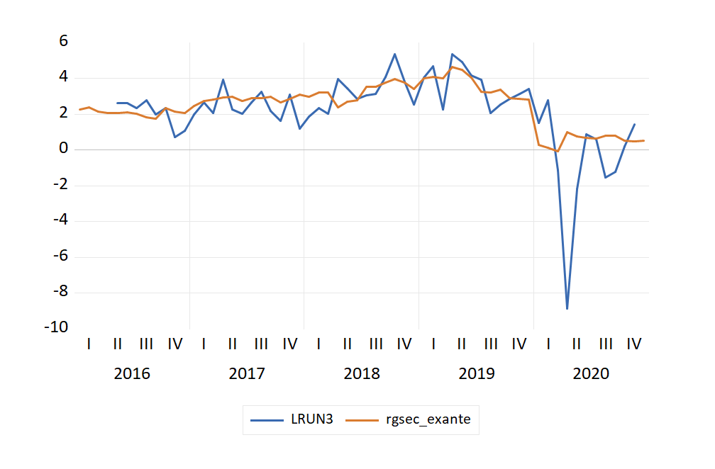

Q2. I need some guidance in understanding the cointegration relationship especially how to understand if "the cointegrating relationship is either of the usual kind, or is valid but degenerate".I ran a test model following the instructions. Attached are the results.
I tried using replacing one of variables (rtb_exante = REAL TBILLS) with other variables. However, I am getting more or less similar relationships as shown in the graph attached here. I am just trying to understand if I am committing any silly error in estimation process itself or could it be that my variables have this tendency/relationship amongst each other.
