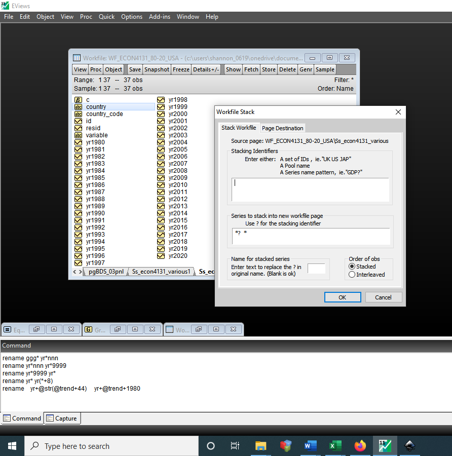

I have imported it into a page, then stacked it ... of course it contains all the data ...

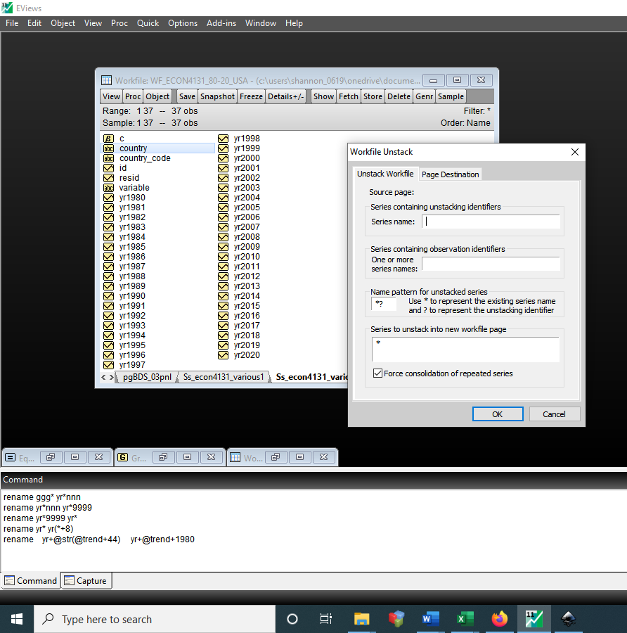

I am using the Proc/Reshape Current Page/Stack (Unstack) in New Page way of doing it ... but I do not think that I can add a command in the available forms ...
