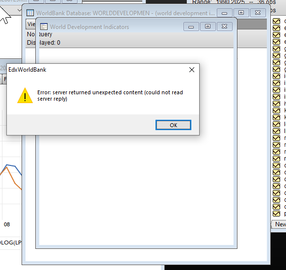

Hi, I am experiencing a similar issue with the WB database (attached is a screenshot). I am also attaching the output of supportinfo command.
Any ideas what can it be?

- EviewsWB.png (30.3 KiB) Viewed 14367 times
EViews Katerina
- Posts: 51
- Joined: Thu Jun 25, 2015 9:54 am
Re: Problems in accessing foreign databases
We will have a fix on next patch of EViews. As of June 19 2020 Worldbank released version 2 of their API and discontinued version 1 (used by EViews). We will make the updates and release a fix.
Fantastic ;). Thank you!!!
EViews Katerina
- Posts: 51
EViews 11 Patch (August 4 2020 build) has a fix for WorldBank database.
