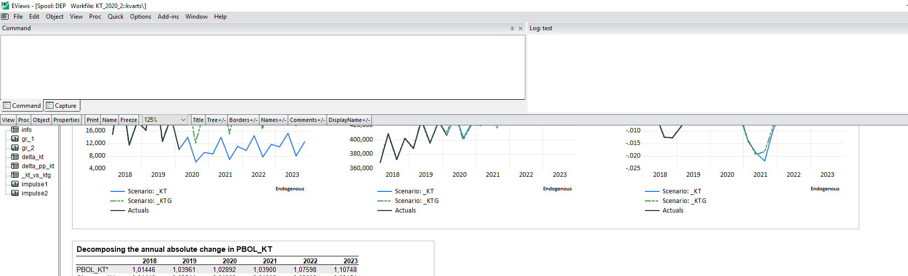

How can I change the width of a table in a spool object? In the following picture, the table is too small relative to the graph object, and I would like to increase the size of the table:

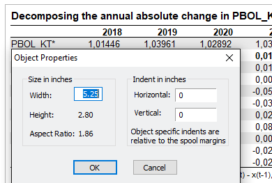

Increasing the width of the table (and thus the size) can be done by clicking around in the spool object, see
but I cannot figure out how to do it with commands...?

Use the 'Width' proc. More information can be found here:https://eviews.com/help/helpintro.html# ... width.html
