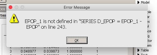

In the line of code which says: series d_epop = epop{%sufsim} - epop , I was getting the following error message:
Screen Shot 2020-06-06 at 5.33.54 PM.png (36.53 KiB) Viewed 5415 times
I would appreciate it if someone could help resolve the error.

Regarding future data, if you can't find someone else's forecast, you can always make your own. Many of the series bundled with the FRB/US model simply use the last known value for all future values.
Regarding the %sufsim = "_1" line, if you look at how that program variable is used in the model scenario procedure you'll see that it defines the scenario alias. When the model is subsequently solved, the solved endogenous variable series all have that suffix. The error message about epop_1 suggest you have not added epop to the model as an endogenous variable, thus epop_1 is never created.
