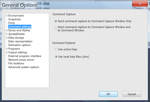

Check the command capture setting by going to the Options menu/General Options/Command capture and make sure the "Send command capture to Command Capture Window Only" is selected.
If this doesn't help, please provide some more details and a screenshot of what you are seeing.

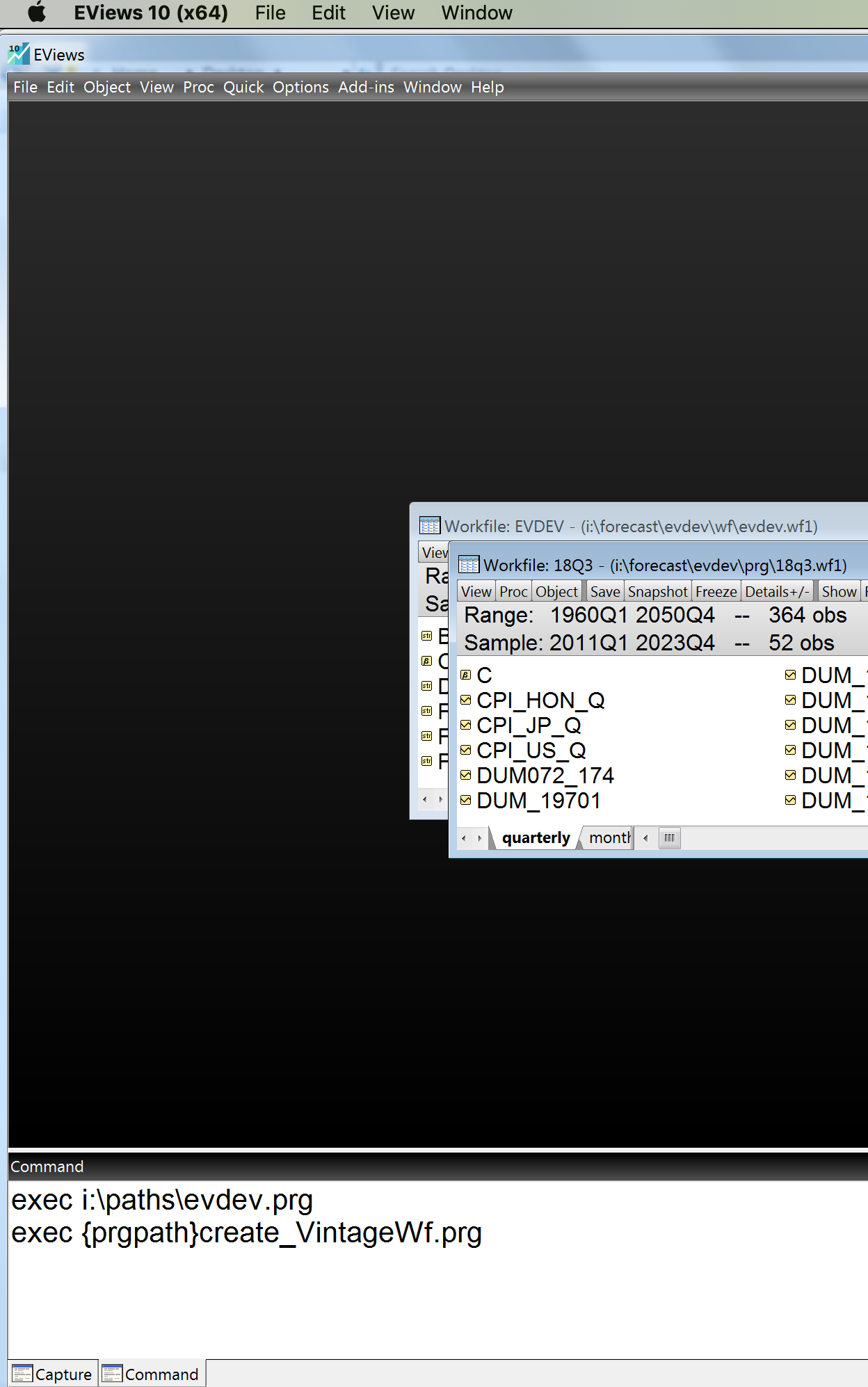

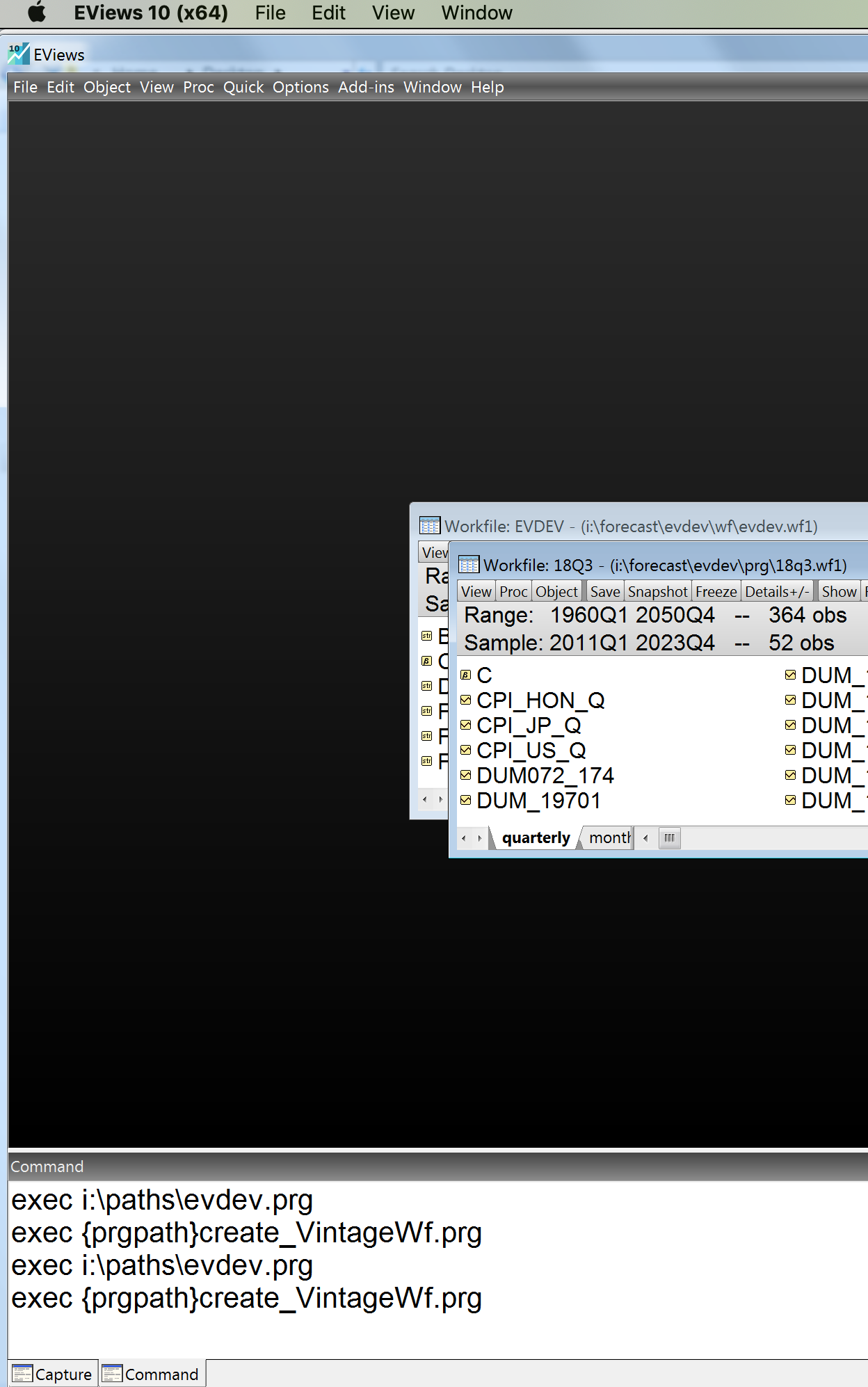

I have set command capture to "Send command capture to Command Capture Window Only".
I typed one line of code and ran it (hit enter/return). Then I typed the second line of code and ran it. (See screen1) When I move my cursor to the first line and run it again, the code is repeated as line three. When I move my cursor to line two and hit return, that line of code runs and is then repeated as line 4. (See screen 2) Sorry for the full size images.
Not only is the behavior inconsistent, but after a few minutes of work on programs, the command line is overflowing with duplicate lines of code.

I'm not sure why you think the behaviour is inconsistent. It is very consistent - every command you issue (whether it is a new command or a re-issuing of an existing command) is shown in the command window.

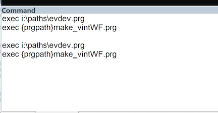

Shouldn't the Command Capture Option to "Send command capture to Command Capture Window Only" result in no executed commands being sent to the command window? It certainly does not work that way on my install of Eviews 11(latest version). In fact, when I execute commands in the command window with the setting set to command capture window only, the command is repeated in the command window, but does not get sent to the command capture window. If I use a menu to execute a command, then it shows up in the command capture window and the command window. Is there, any setting to stop each executed command in the command window from being sent back to the command window. If not, can that feature please be added. As someone who prefers typing commands to execute programs and other commands, my command window is quickly overwhelmed with tens of duplicate lines of code.

Are you saying that when you type a command in the command window, that command then gets repeated in the command window? So if you type "series X=nrnd" you end up with two lines that say "series X=nrnd" ?
Re: disable repeating code at command line
Gareth,
Yes, that is exactly what I mean. In the attached iamge, I typed the first two lines in the command window and executed them one at a time. The last two lines are the repeated lines Eviews generates.
