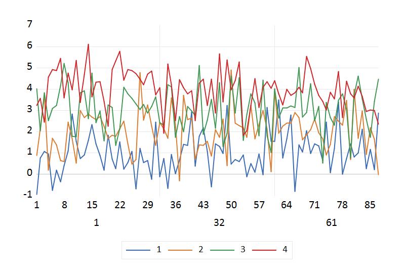

When graphing a dated panel, I am looking for an approach to show the @obsid rather than dates on the obs/date axis
With the below example code I get the following graph. While this comes close to what I am after, the figures in the second row of the obs/date axis labels look quite odd. What do these figures mean, and, more importantly, how to get rid of them?
Best, mamo
wfcreate d7 01/01/2020 03/27/2020 4 series x=nrnd+@crossid graph gra.line(panel=c) x gra.setobslabel(obsnum) gra.datelabel interval(obs, 7, 01/01/2020) show gra

I'm not sure you can, unfortunately.
You might be better off removing the time dimension from the panel, and using an obsid series as the 2nd dimension, rather than time.

O.k., there is indeed the workaround of restructuring the workpage.
Nevertheless, this seems to be a bug as one would expect the observation-id (and only the observation-id) to show up on the date/obs-id axis when respective option is selected.
