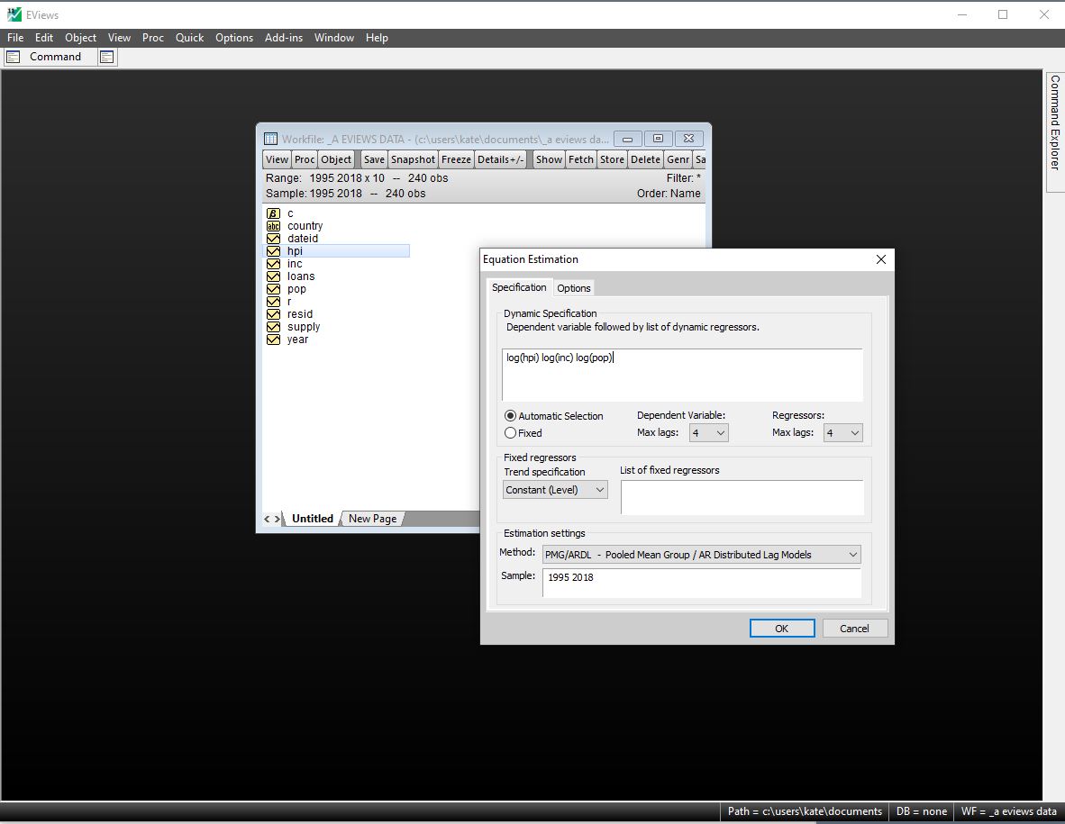

I am analyzing real estate prices using panel data for a number of years/countries. It has been working fine at work (with a paid licence). I am using a demo version of Eviews 11 at home. That's when my PMG/ARDL estimation stopped working.
When I upload my data file, the data are recognized by Eviews as a panel (s. capture). But when I choose "Quick -> Estimate Equation -> PMG/ARDL" I get this error message: "log(hpi) is not defined". Other methods of equation estimations DO WORK. I need to run a PMG/ARDL though, because my variables are non-stationary (house prices, income, population).

This is a bug in current shipping EViews (of which the COVID Demo license is a version). We'll fix it asap.
Re: PMG/ARDL fails to run/produces error
Postby EViews Gareth » Wed Mar 25, 2020 8:20 am
In the mean time, try doing it via command line.
Postby EViews Gareth » Wed Mar 25, 2020 8:37 am
Or, specify the equation in all caps:
LOG(HPI) LOG(INC) LOG(POP)
