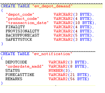

Also, how do you know the table name has quotes around it? Can you provide a screenshot of what your seeing that shows the quotes?

I attach the image. When we call the table without quotes around the table name there is no table available. Is this helpful?
The database is Oracle.
Another perhaps unrelated subject is related to the variable names. Do you know why some variables have quotes around them and are in lower case? Everything is saved in lower case.

I took a close look at our ODBC code and we use quotes around any names that have an underscore in the name (table names & column names).
This was due to some ODBC clients requiring this, but not Oracle. I turned this off for Oracle so this will be available in the next patch. In the meantime, you can avoid using underscores in the workfile and object names to avoid this problem.
I think the column names are appearing in different cases because we push all lowercase names, but the ones that are quoted are kept in that format while the others are reformatted to Oracle default uppercase.
