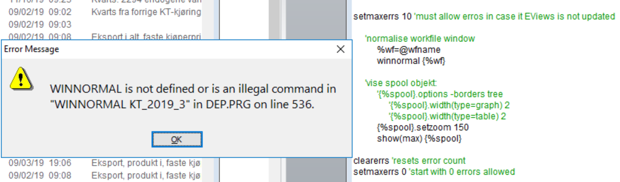

How can I include these new commands in an addin so that they do not cause an error if a user has not updated EViews yet? I tried setmaxerrs, but that did not help (see picture below)
Re: Minimize workfile window
Postby EViews Gareth » Sat Nov 16, 2019 10:06 am
Use the @builddate function
Postby tvonbrasch » Sun Nov 17, 2019 1:13 am
great, thanks!
