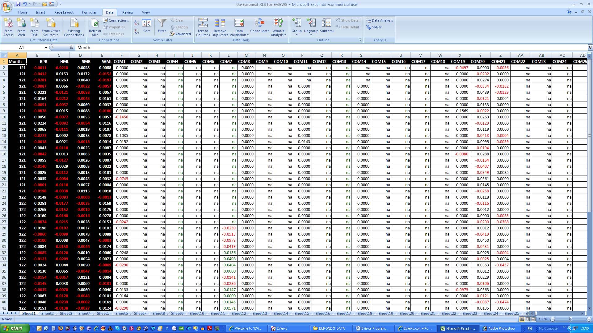

Unfortunately, the above script is not working and I can't see why (as I mentioned earlier I am not any good at all with programming. Any help will be greatly appreciated. I am using eviews 6. So, all my 254+ columns spreadsheets are first saved as txt first (tab delimited) and then imported into eviews6.
PS.
I have also attached a sample of the spreadsheet in picture that I use as a pilot data source if any if you want to have a look on the data (this is only two calendar month, 121 and 122 calendar months). Also, can someone suggest a book for starting with programming....(something for people with NO PRIOR EXPERIENCE whatsoever in programming).

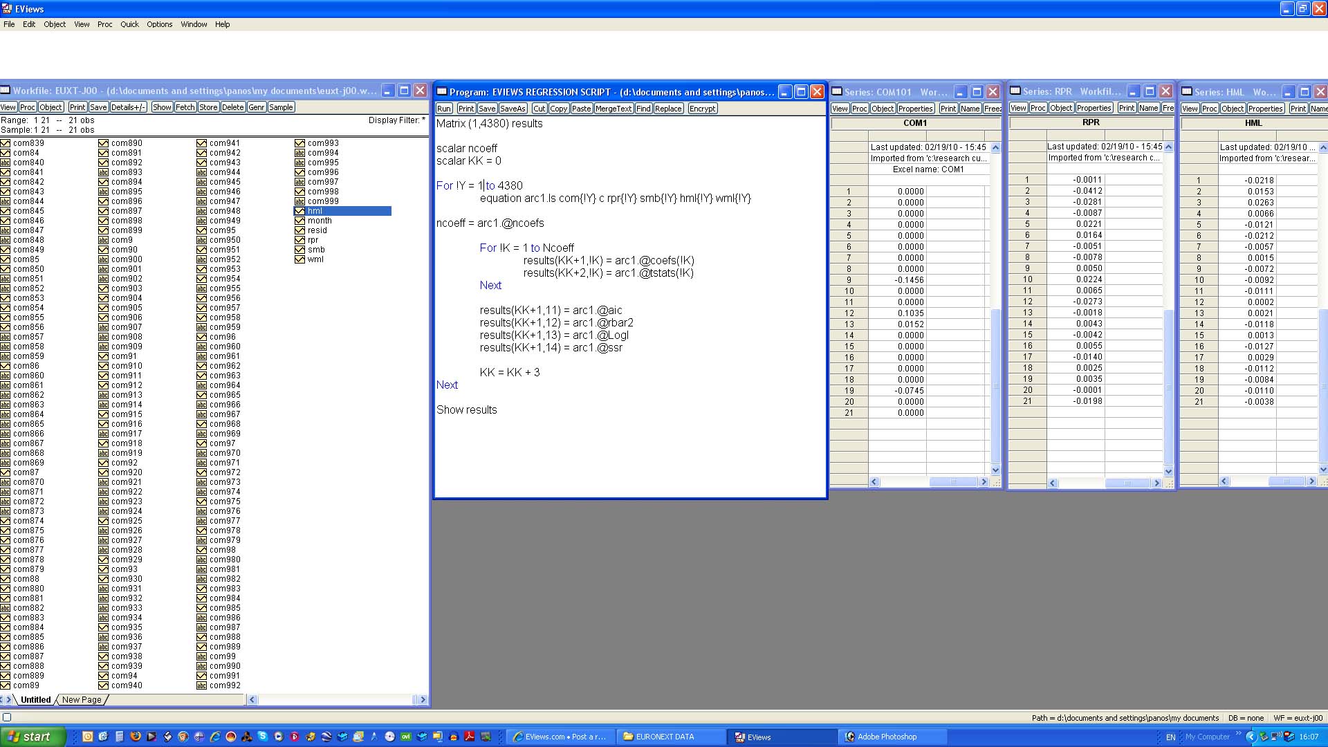

Dear Gareth,
thank you for your prompt reply. The message I recieve is "COM1 is not defined in Equation ACR1.LS COM C PRP1 SMB1 HML1 WML1". It seems to me that what I wrote is incorrect as I mostly want it to run each dependent com1, com2....ect against independent (the same series all the time) rpr, hml, smb,wml. Once it do this for each of the com1,2,3..n dependent to go and store them in a matrix (1row x 4380columns) (one column per dependent), and for the general results to report all of the summary stats in the scalar ncoeff (I might be completely wrong here in the way I am writitng it). See the attached script *eviews6 window). I can't really see what exactly it means as COm1 is not defined as I "assume" that I defined com1,2,3...,n to the "For !Y = 1 to 4380"
- eviews6.jpg (337.35 KiB) Viewed 6797 times

That error message is indicating that it can't find a series called COM1. Are you sure there is such a series?
Also, looking at your screenshot, it appears that a lot of the visible COM series are in fact alpha series, not numerical series (you can tell by the little ABC symbol). You won't be able to run a regression with those variables.

yes, I know that. I assume that the eviews will skip these alpha series once the script starts running. Also about the com1, once the table was imported in eviews this column was changed to COM101? Even if I exemppt this series and start from
For !Y = 3 to 4380, the mesage that comes immediately is "RPR3 is not defined in Equation ACR1.LS COM3 C PRP3 SMB3 HML3 WML3". But how can I have rpr3 when I only have 1 series for rpr?....Also if I delete the {!Y} symbols from the independent variables as I have only 1 series for them and make the "equation arc1.ls com{!Y} c rpr{!Y} smb{!Y} hml{!Y} wml{!Y} " into "equation arc1.ls com{!Y} c rpr smb hml wml", then message then is: "Aplha series in specification - COM3 @EXPAND can convert to categorical dummies in "equation arc1.ls com3 c rpr smb hml wml".

Ah, I hadn't understood you wanted different dependent variables, but the same regressors. In that case, yes, you will need to remove the {!y} from the dependent variable names.
EViews will always error on the cases where you have the alpha series. You can tell EViews to skip errors by setting the error count to a high value when you run the program.
