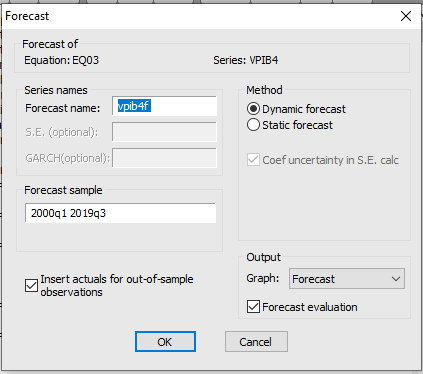

In forecast, after estimate MS Model, does not appear check box to standard. error, to make confidence interval.I'm don't understand the request.
How can i make confidence interval for this models?

- Posts: 2682
Re: Markov Switching Regression
Unfortunately, computing forecast standard errors for MS switching is extremely difficult and not currently supported. Support will almost certainly have to be using simulation methods, which are likely to be computationally intensive. I'll put this on the list of things to consider for future development.
