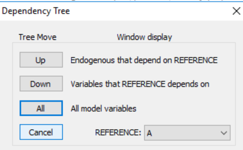

It is a really nice feature that one can identify dependencies in the model object,
The down dependencies I have managed to find using the SPEC command, however, is there a way to identify the UP-tree using commands, i.e. the endogenous variables that depend on the reference variable? (If not, can you please add this functionality?)

There is a pair of undocumented model procedures for returning upwards and downwards dependencies. model.@depends("foo") returns a string containing the variables that "foo" depends on (downward), and model.@upends("foo") returns a string containing the variables that depend on "foo" (upward).
